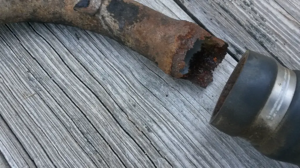

Here's what it looked like after i took the old one out:

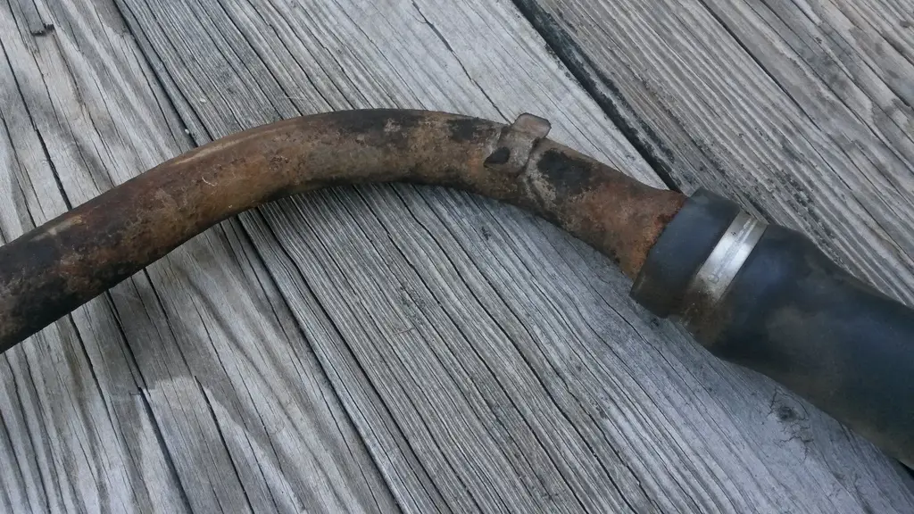

Never happy unless I can see exactly why it was leaking, I gave the metal tube a slight twist to see if it would come apart and that's about all it took:
So, if your Explorer starts leaking gas from the fill tube while you're filling it, I'd get on this pronto. As you can see, there was nothing but rust holding this thing together. I feel very fortunate that this didn't blow apart while I was filling it up. The only evidence I had was a couple of drops on the ground the last couple of times I got gas.
It only took about an hour to change and cost was $145 shipped so it was well worth the $$.

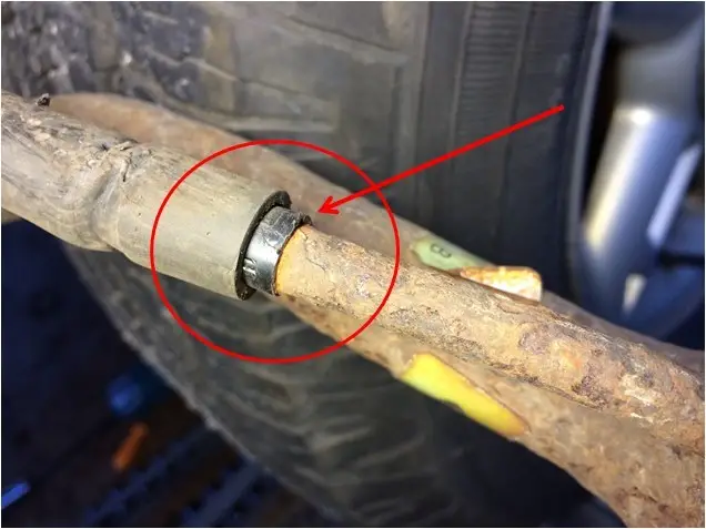

So I'm in the middle of this same job, and I ran into a problem. I'm wondering if you saw the same thing, and how did you handle it? I'm at the library trying to find some information in ALLDATA, so I can't post pics until later.
At the top of the fuel filler neck is a small-diameter return line comprised of a metal line attached to the filler neck, and a hose with a hose clamp. The new filler neck I purchased has the metal line, but does not include a hose.
For my life, I cannot get the small-diameter rubber hose off of the metal tube. I can twist the hose and pull it back about 1/2 inch, but it won't come off (but it WILL bunch up). On the existing metal tube, it looks like there is a plastic coating that is VERY well-bonded to the metal tube. I'm wondering if it is actually a hose liner or something. It would explain why the hose is bunching instead of slipping off the filler neck.
So, did you come across this when you were doing the repair? How did you handle it?

Ok, here's a pic of the problem part. Did you come across the same thing, and how did you handle it?
My old filler neck was stuck on pretty good. I sprayed it with LPS oil and pryed it with a screwdriver to get it off. Then had to clean / scrape the rust from inside the rubber hose
Pretty much the same thing I did. I had to use a little petrolatum (Vaseline) on the end of the new metal tube to get the hose to slide back on.
I do not remember coming across that plastic liner thing either.
