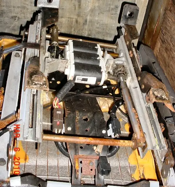

Here's a view of the under side of the seat, 2001/power. One or more of the support wires must have broken. Just remove the seat, unbolt the track assembly from the seat frame and get some suitable replacement wire to replace the broken ones. Should be fairly easy to do.

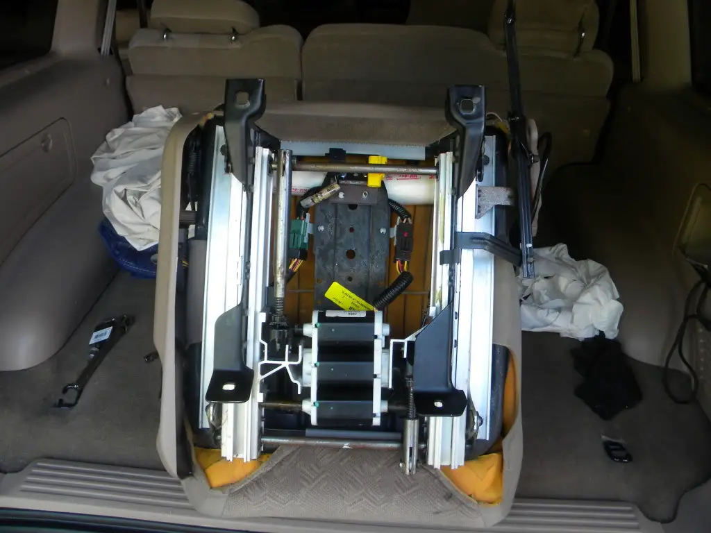

Did pull the seat out, but unbolted the seat from the tracks instead, as the seat unit would not pull free from the rear catch after unbolting the two front bolts, and wrestling with the entire seat assembly. Any hints there for the next time?

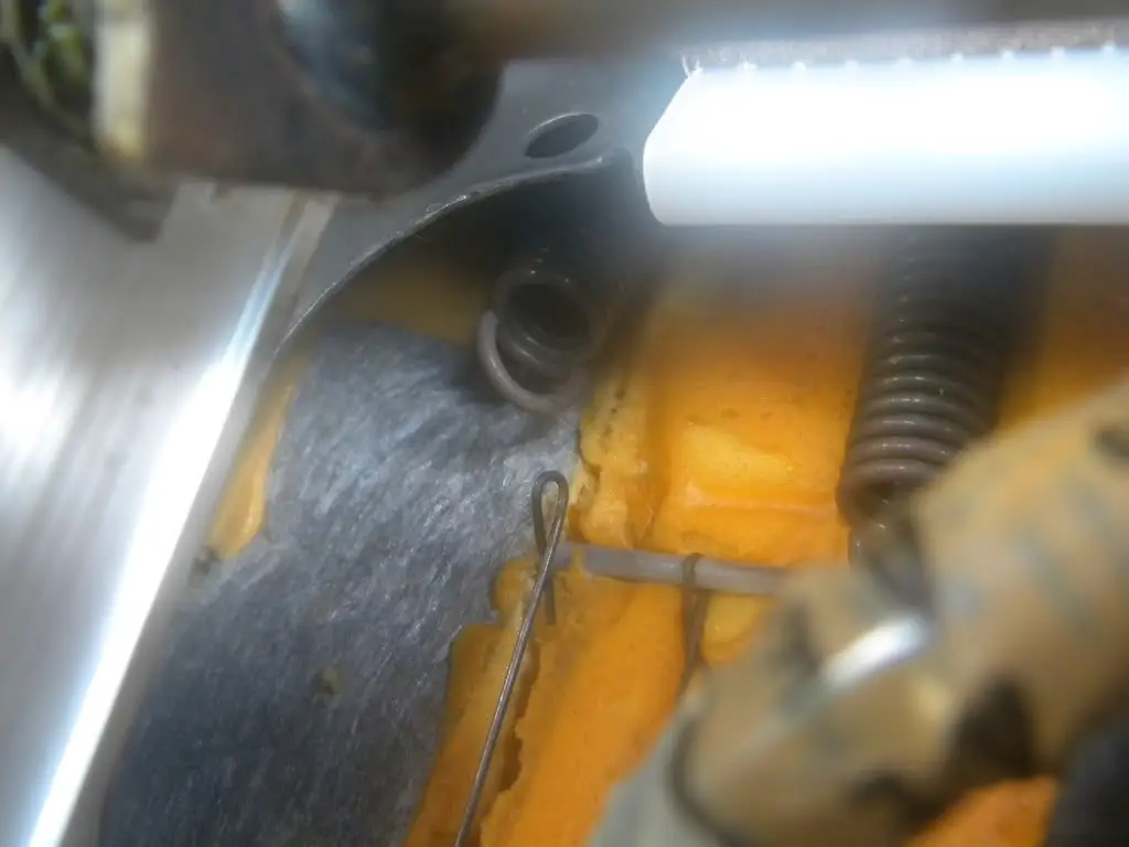

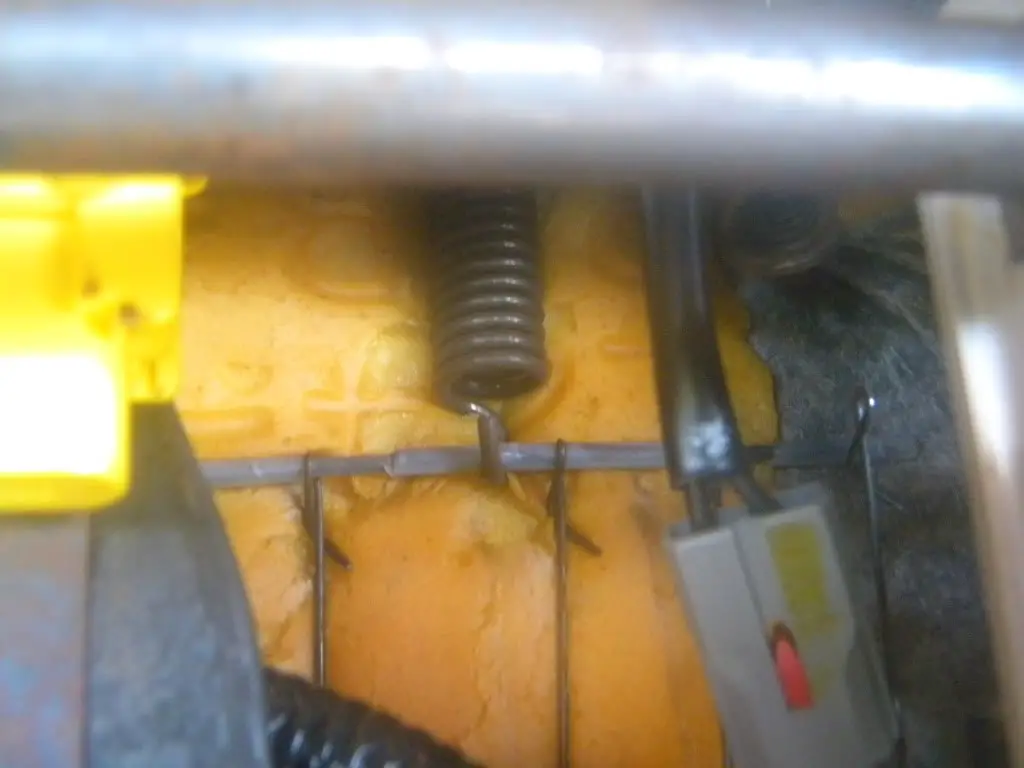

Found that the center "grid" rear tensioning spring had broken it's mount on the seat frame. I drilled a 1/4" hole 1/2" below the slot created from when the original spring mount was punched out during fabrication, and used this hole to secure the tensioning spring, and then re-hooked the spring onto the srupport grid. Viola! Fixed.

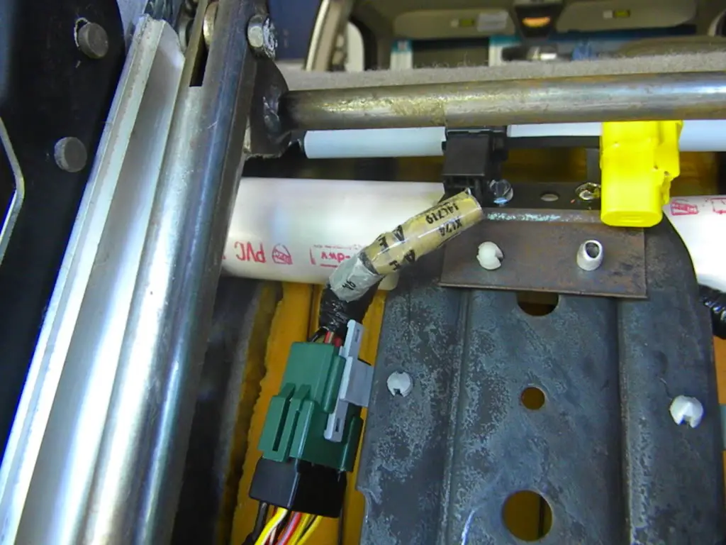

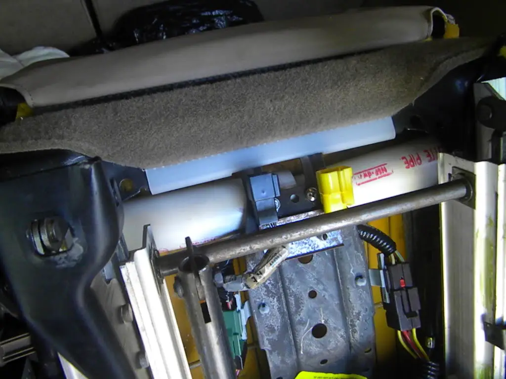

I solved this by inserting two 6" pieces of 1 1/2" PVC pipe for added support against the cushion.
Heres the solution. Notice the white PVC pipe. Its between the steel frame and the cushion. This is on the back of the seat.

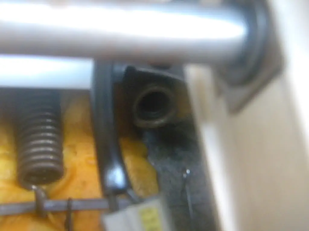

Something just gave up again, so I have to pull it out. As well, the recline is broken.
FFStak - can you re-post the pics?
Sure. As far as the reclining goes, i have seen posts on this forum with that issue. The lever assembly with the sping can be taken off from the side of the seat without removing the seat itself. that just makes it easier to work with however.
You can see all the way on the right that the coil spring has popped off
