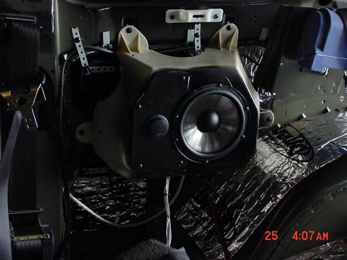

Here are some pics of the install I did in my X. The three circles in the first pic are where the amp rack is secured to the vehicle.

I ended up doing an install like bigtig, though without the light. (I even have an MTX amp) What I ended up doing was taking out the stock amp rack/sub enclosure, and tracing it to a piece of 3/4" plywood that I was able to get as scrap from my old high school (mom still works there, membership has its priviledges :) ).
I cut, sanded, and carpeted it. Put it back installed it with some long bolts and 3/4" nylon spacer for top row of screws to account for the fact that the bottom two screws sit out about that much farther than the top three. When I went to put the panel back on it didn't fit quite right, so I pulled everything apart again (much easier after doing this for about the fifth time). I undid the carpet on a couple of sides and trimmed the wood.
Stapled the carpet back in, mounted everything back up again, and voila, it fit.
I did leave the grill off though to assist with getting air to this new amp as it runs hotter than the stock two. I left the stock amp in about its original location because I still use it to drive the door speakers.
I also used 8 guage wire for everything (power, ground, and speaker wire) .
