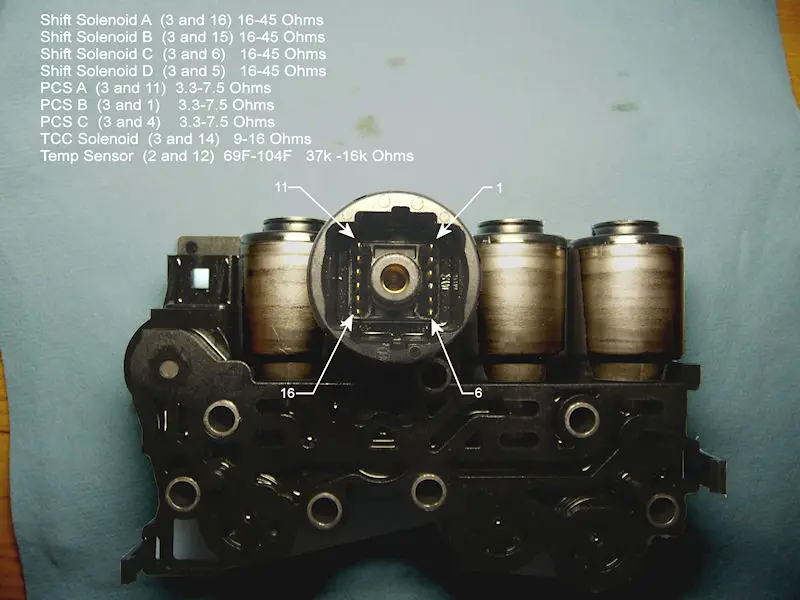

ok so I got the pan off, fluid looks and smells like new. No chunks or pieces in the pan. I pulled the solenoid block and tested it. results were
shift solenoid A 27.6 Ω
shift solenoid B 27.6 Ω
shift solenoid C 27.6 Ω
shift solenoid D 27.4 Ω
PCS A 8.4-8.5 Ω (toggles back and forth)
PCS B 8,4 Ω
PCS C 8.4 Ω
TCC 13.9 Ω
temp sensor 32.1 KΩ
Now from what ive seen so far, everything is in the proper range except the PCS's, which are reading 0.9 Ω higher than what ive seen. Would this cause the issues I'm having? If not next I'll be checkin into the bands and servos.
using this pic from another thread on here i found.
