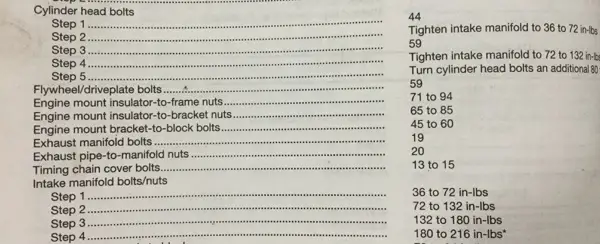

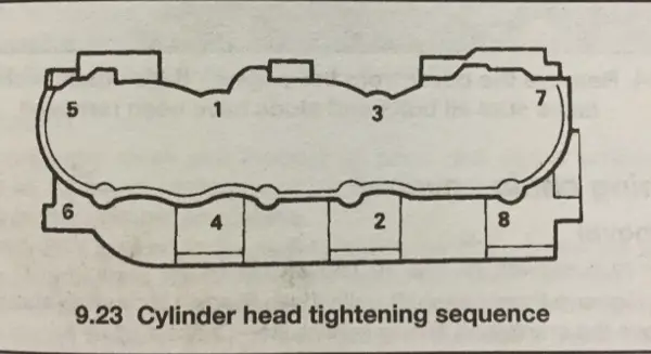

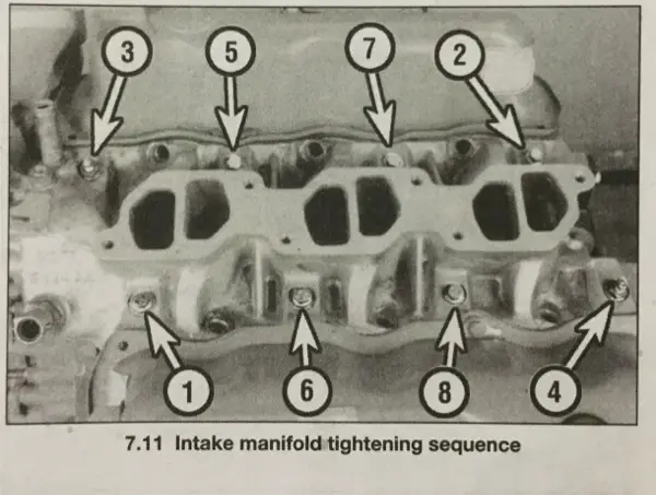

Step 1: Cyl Head Bolts (CHB) 44' lbs
Step 2: Intake manifold bolts (IMB) 36-72" lbs
Step 3: CHB 59' lbs
Step 4: IMB 72-132" lbs
Step 5: turn CHB an additional 80-85 degrees. (Apply paint mark to note amount of turn.)
Then, intake has two more steps.
132-180" lbs
180-216" lbs
After running engine, retighten at the 180-216" lbs.
Make sure you've chased the bolt holes with a bottoming tap and put a little engine oil under the CHB flanges.

I've heard this before, but I'm not sure I buy into the thinking. I can't think of another engine that requires that sequence. The pictures look like those from a chilltons, or Haynes manual, and I don't trust either. In the whole manual, they are only ever about 75% correct. They have way too many mistakes, wrong installation instructions, wrong torque specs, even wrong fluids.
Every other engine, you put the heads on, then the intake manifold. You can do it any way you like, but the fact is you will be fine either way. You're just smashing a gasket between two metal surfaces. I've known people to not even use a torque wrench and still be just fine.
I've done both, one way because of LIM bolts constantly loosening up and the other because I had a bad head that needed replacement. While there are merits to both approaches, I had the best luck with torqueing in sequence with heads. Keeping in mind head bolts are one time use, TTY style bolts. Studs and 10.9 or 12.9 head bolts are available that can be used though.
