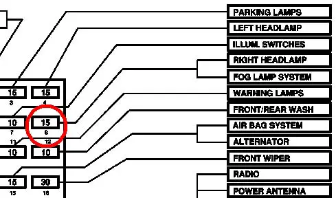

Robb - fuse 8 is a 10amp and is not blown
The passenger (low beam) headlight and the foglights are on a circuit all by themselves. The circuit is protected by fuse #8 in the fuse panel. If this fuse is not blown, you need to get your hands on a volt-meter (or 12v test light) and check for 12 volts on both sides of the fuse (little metal prongs on the top of the fuse while it is still plugged in), and at the headlight socket itself. This will help determine where the open is in the circuit.

Thanks Robb, I'll test the fuse and the socket. Would the 10 amp fuse in #8 be an issue? Your fuse map shows it to be a 15 amp but I've got a 10 amp in there.
Thanks again Robb, I'll let you know what I find out.
