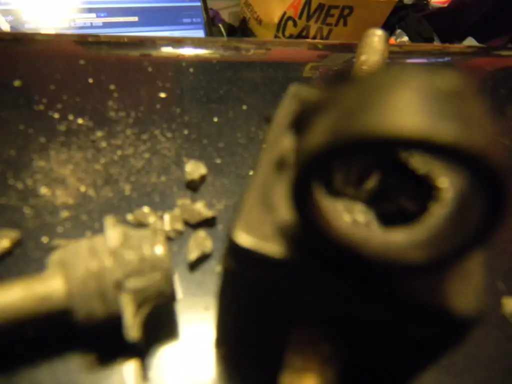

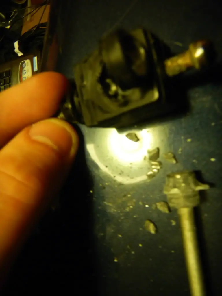

Here are pictures after i broke it apart, i figured out why it doesnt work anymore at least
Yes those metal flakes are the actual gear being stripped
