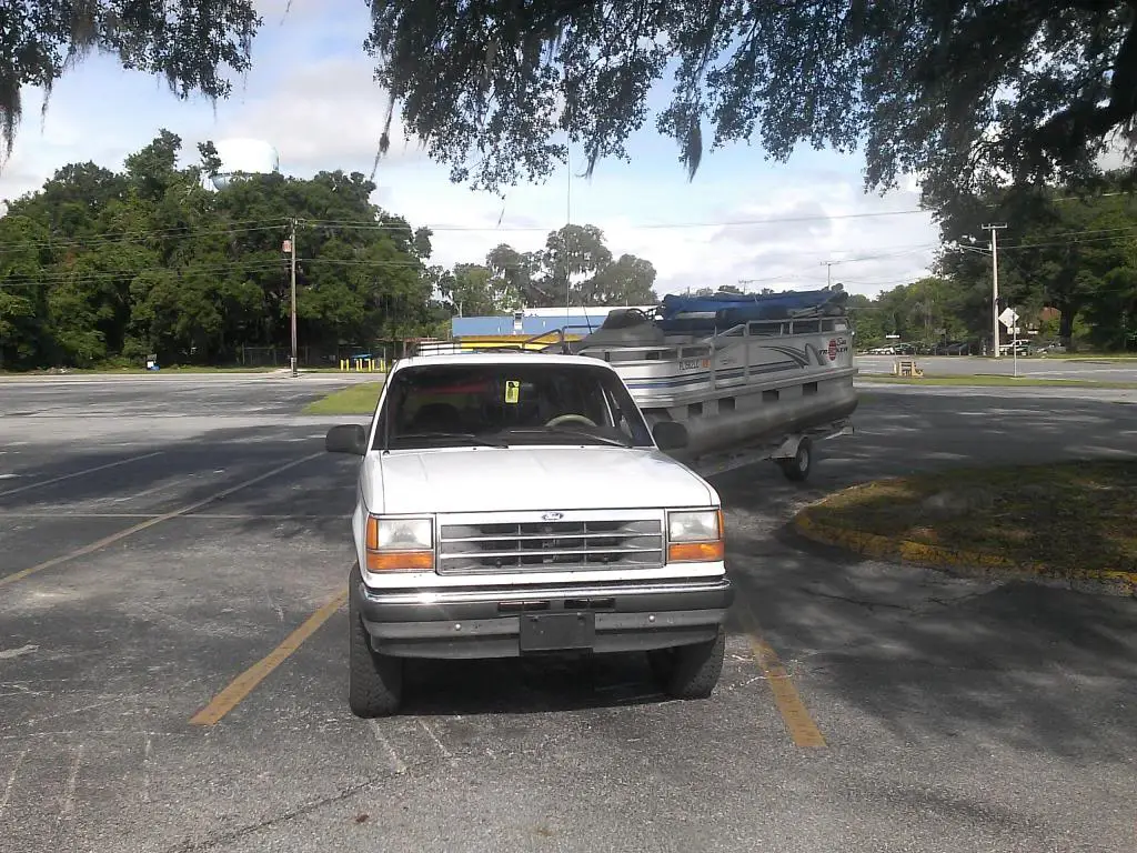

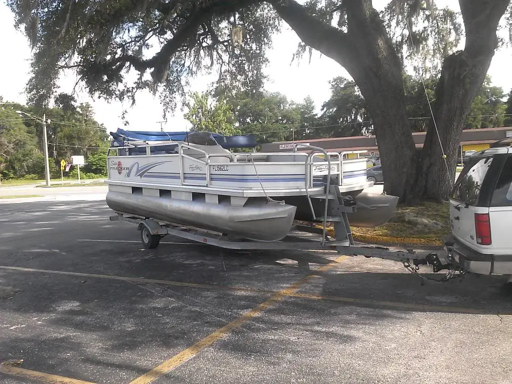

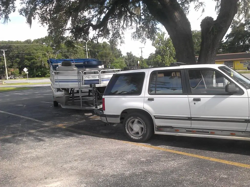

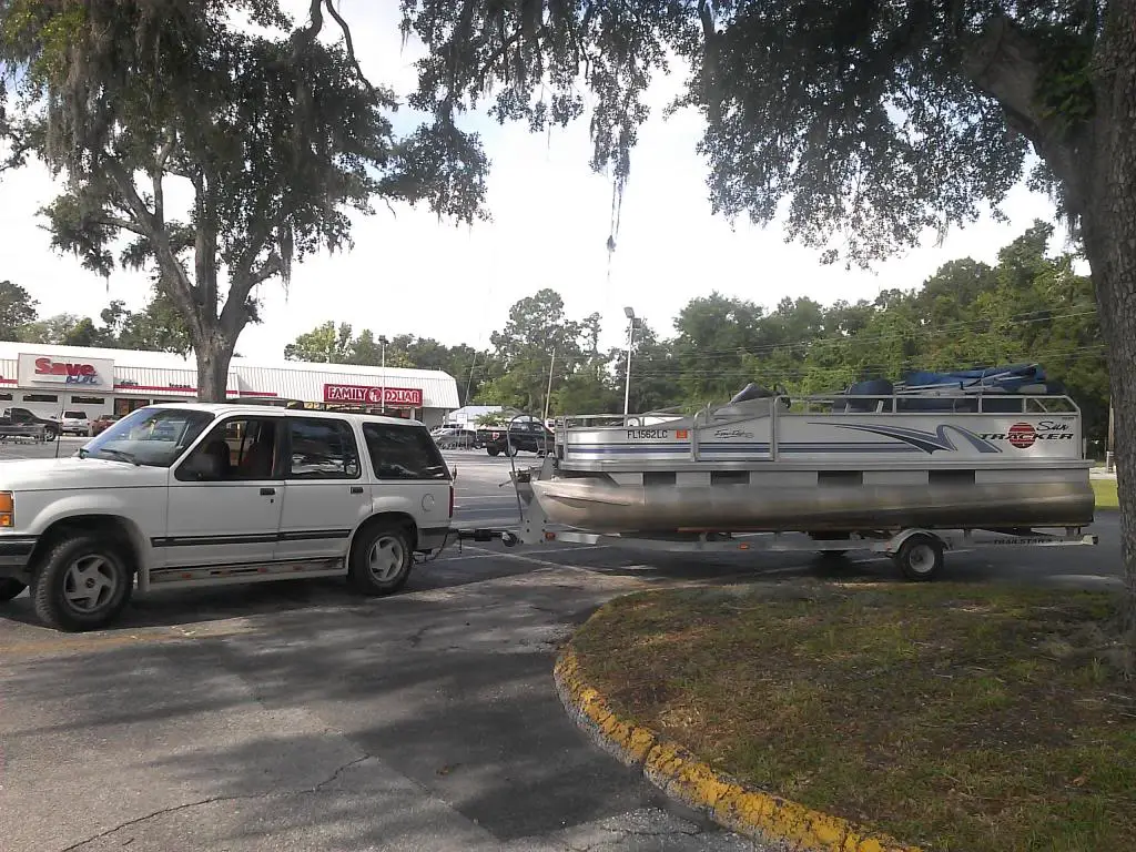

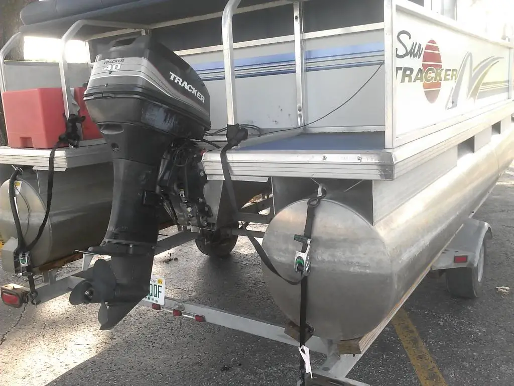

okay i just got me a boat its a decent sized boat 20' pontoon boat trailer and 40hp motor well i was towing it for the first time today for any distance to test it and see what it would do with my 1994 ford explorer 4x4 and it normaly sits right about the n on the normal gauge but when i was towing coming out of town about probably 25 miles or so it got up to the L by the time i got home which worried me a little mostly because i want to go on longer trips later like around 100-120 miles or so with it and if it did that after 25 then it would not be able to go that far my best guess is that the boat loaded weights in the neighborhood of 3000-35000 lbs also i have the 3.73 axle and 235/75/15 tires on my explorer other then that it is stock with 135,000 on it i also did replace the thermostat in it about 8 months ago with a 180 degree and at the same time did a radiator flush on it. any ideas as to what could cause that? thanks now on to pictures
You need to find out how much your tow weighs. You're limited to about 3500 pounds total towed weight, and by looking at your photo's, it looks like you may have exceeded the tongue load already.
Wow! Look at the rear-end squat! You'll be blinding oncoming drivers if you tow at night. You probably do not have a HD towing package, which explains your lack of cooling capacity. Like previous post said, at best you have 3500 lbs towing capacity, and that boat/trailer leaves you with no capacity for cargo/passengers in the Explorer.
Time for a new tow vehicle with at least 5000 lbs towing capacity.
