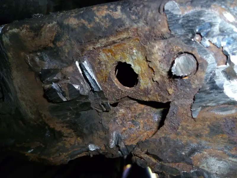

whats left of OE brackets

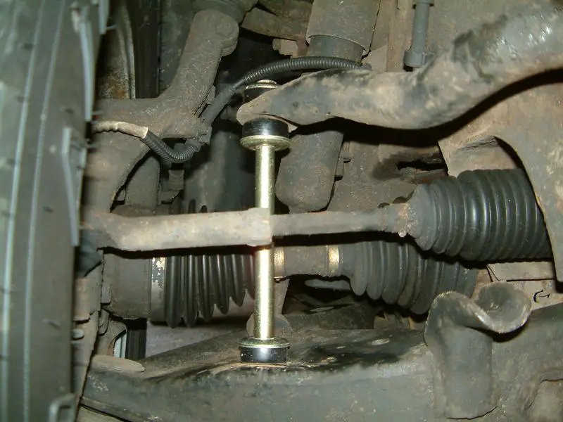

pics of new off side drop links and universal ARB bushes/brackets
