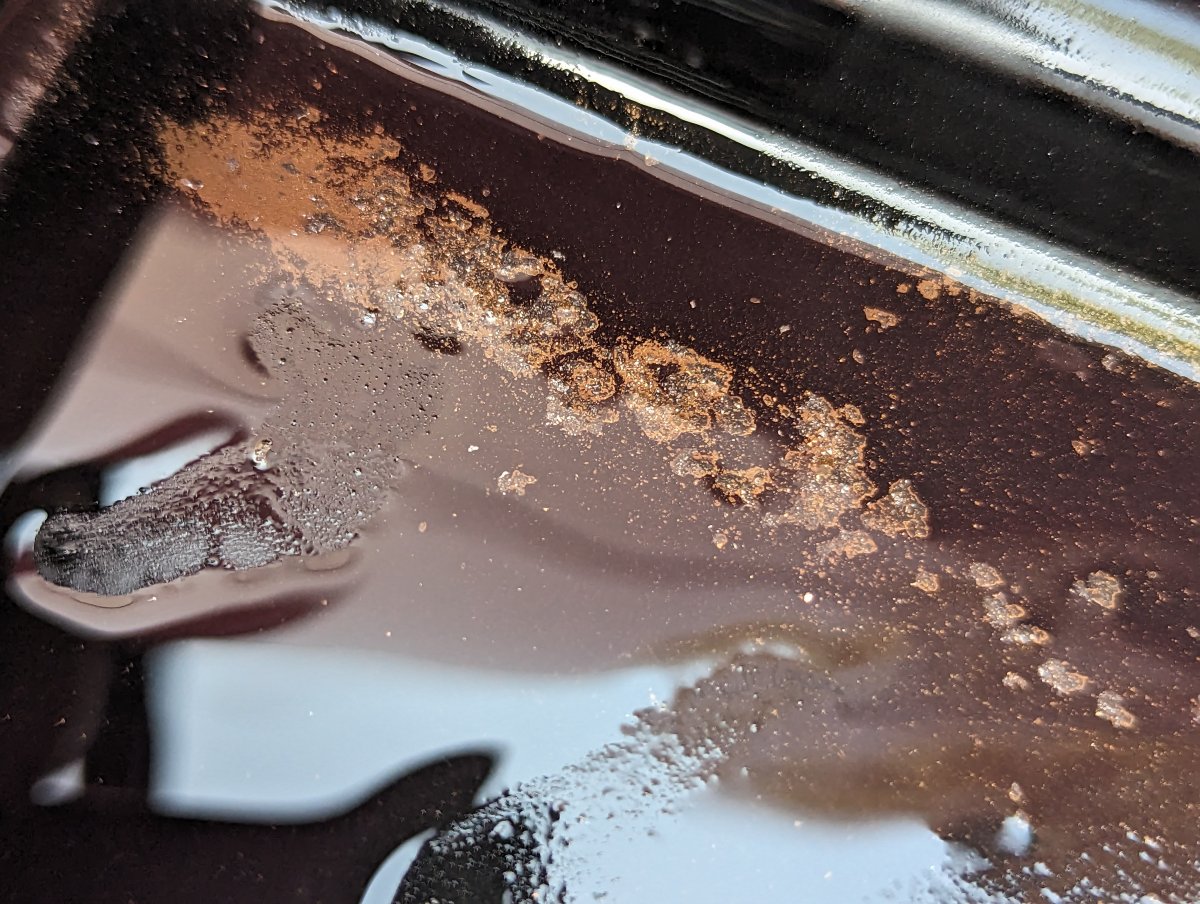

I recently dropped the transmission pan, as I starting having more transmission trouble. Issues I am now having include stuttering when coming to a stop (between about 0.5-5mph), occasional stalling when going from reverse to drive and also making a turn, and now it hiccups while cruising on the highway regardless of it being in D or OD. The transmission doesn't slip when I floor it, or when I do a gentle acceleration. I noticed a loose bolt on the valve body, so I re-torqued all the bolts and snugged them down, but it hasn't fixed the problem. I noticed some goldish colored material in the pan, and would love to know what it could be. I absolutely do not have the time nor do I have the money to replace the transmission, so I'm hoping this is something I can do in a day, and under $400. In the mean time, I dumped a whole bottle of Lucas stop slip in there, and I'm crossing my fingers.
