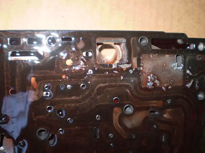

2000 Exploder 4.0 sohc 4x4 5r55e. Putting a new valve body in to try and solve some issues and upon taking out the old valve body I found some small pieces of ground up metal on top of valve body (see below). Should I not bother putting my new valve body in or is this somewhat normal?? Thanks for your replies

ooohhh! I don't know alot about trannys but that looks mighty discouraging. Good luck with that
I also cant really be of help other than to say, thats definitely not normal....

Internal hard part damage will probably get into a new valve body, so it might be a good idea to rebuild the transmission. You could rebuild your current valve body, and use it until an accumulation of hard parts get into it again. I think it's on borrowed time if there is already some part that is failing. It's up to you if you want to rebuild everything or just clean it up, and see how long it will last. I know that this wasn't what you wanted to hear, but these fragments are larger than ordinary shavings from thrust washers (which is normal wear).

I would have to concur the tranny looks to be in bad shape..
But I am curious; what does the pan look like?If the valvebody has bits in it, I can't help but wonder what chunks are in the pan...
Do you have apic of the pan after you pulled it off? I have looked at 5R55e valvebodies more than I care to admit but that unit of yours looks awesomely foul...
But the fact that the only real problem you seem to have is no coast clutch would almost make me rebuild the vavlebody and pop it back on and run it... BUT...Unless the pan was completely free of debris would I even consider that...And even then reluctantly....
Pan suprisingly didn't appear too bad although I turned it upside down into the drain pan upon removal. It had a few bits of metal stuck to the magnets which were about the same size as the stuff I photographed on the valve body and alot of metallic goop stuck to the magnets which I assume to be wear from the friction material? Since the new valve body was 260.00 or so I'm more inclined to return it and just go the rebuilt route for peace of mind.
metal bits inside a trans are never good. pull the filter out, break it apart, and see whats inside, chances are, if the valve body has bits on it, the filter is full of them... in my experiance (im an apprentice mechanic), my best bet would be rip the trans out for a rebuild, because with bits in it, its running on borrowed time, and will go when you least want it to. like someone said, slivers are ok (small amount of them), or metalic goop, or maybe 3 to 4 flakes like that, but not that much.
