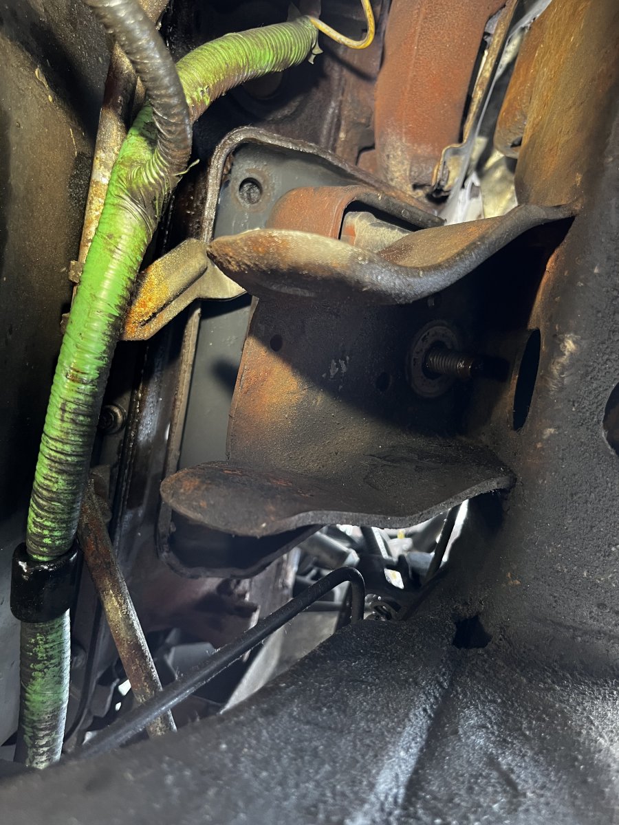

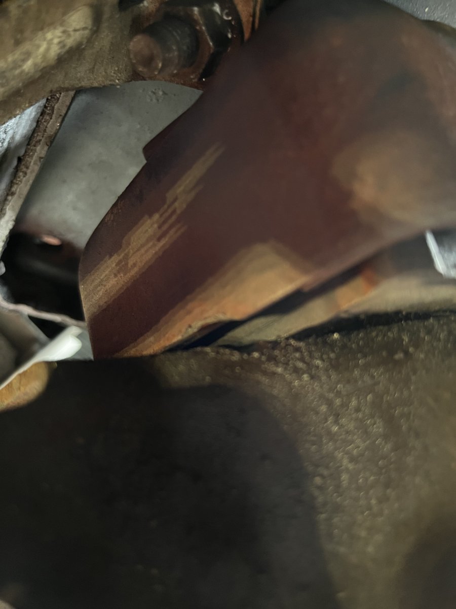

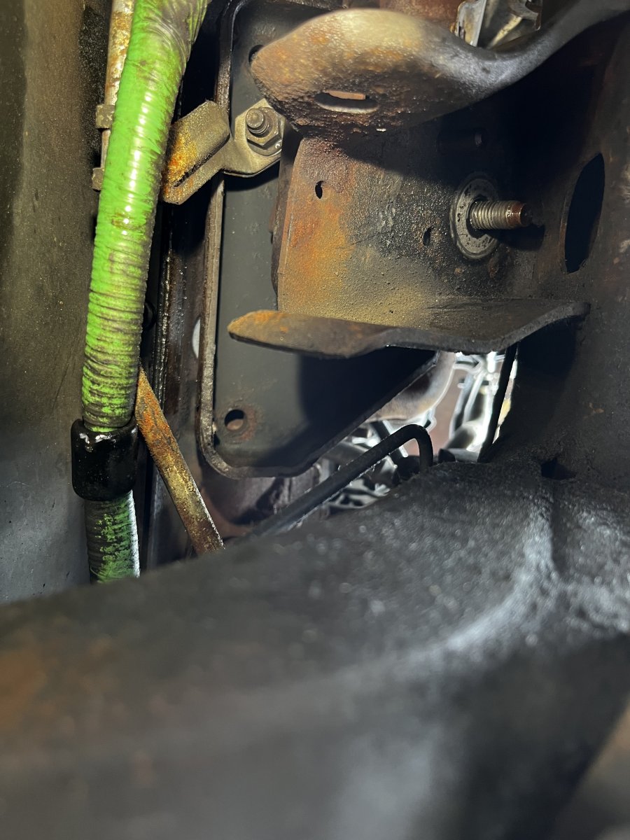

SOS :( so started doing the motor mounts. Found out why it was so bad. The plate that holds the mount to the engine, the 2 bolts that hold it to the engine were sheared off. I also have no idea even if these were not sheared how to get that Mount out of there ? To me it would take pulling the engine.. or can I put a jack under the transmission and lift there ? I don’t want to use my oil pan.

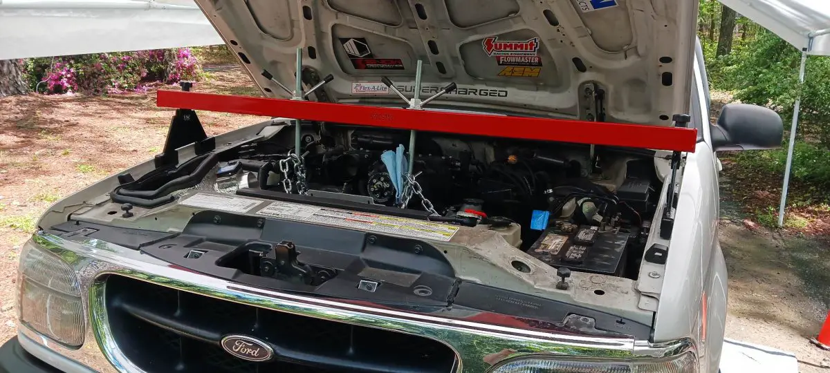

I have one of these things it works great Amazon $100

So I managed to get the motor up high enough with a wood block underneath. But will have to tap out the bots no matter what. Mine are definitely still up in there. Winding what size the bolts are and thread and such trying to google it.
7/16” for the 5.0 I believe, not positive. No idea on the length
