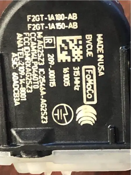

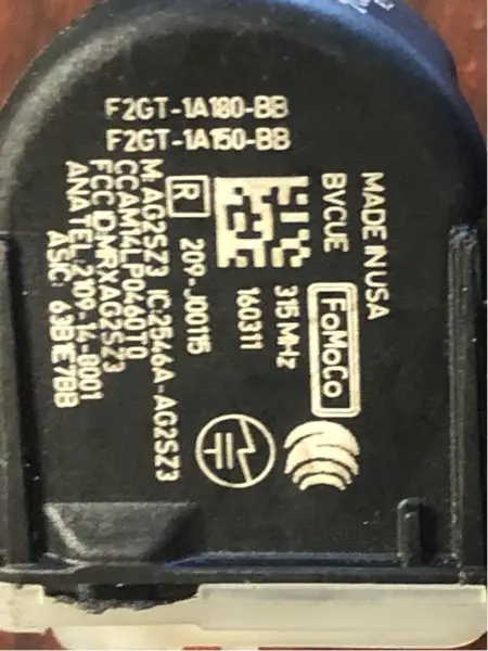

Thanks for the reply. You're right, F2GT-1A180-BB is not mentioned anywhere online, and as it turns out, one of the four sensors I received is labeled that way. The other are labelled F2GT-1A180-AB, which is mentioned, and seems to be cross-referenced in a number of places to the part number you mentioned.
Ford, Lincoln Schrader TPMS Sensor F2GZ-1A189-A, F2GT-1A150-AB, F2GT-1A180-AB, FR3V-1A150-BA, FR3V-1A180-BA, HC3T-1A150-BA, HC3T-1A180-BA, 20280, TPMS-35, TPMS-39, TPMS-42 F2GZ1A189A, F2GT1A150AB, F2GT1A180AB, FR3V1A150BA, FR3V1A180BA, HC3T1A150BA, HC3T1A
Still, I can't get the vehicle to pick up this sensor using the TPMS tool that I bought, but I'm wondering if they need to sense a pressure inside a tire, since I've just been trying with the sensor outside the tires. I didn't want to get them installed if they weren't going to work.
Here are the photos of the sensors I received......
Just as an update. I had these sensors that I purchased on eBay (4 for $19 CAD each) installed by my Ford Dealership. They all work fine, so P/N F2GT-1A180-AB, and F2GT-1A180-BB are equivalent. I believe Ford refers to these as TPMS35.
I also have a 3rd party TPMS relearn tool that I did confirm works with the summer tires, so I'll see in the spring if I can reprogram everything!
Thanks again for the help and advice! I feel good saving $300 at the dealership :)
