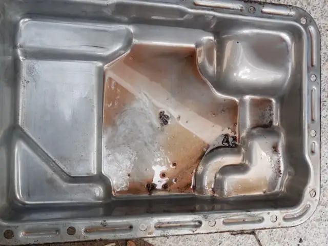

Same thing happened to my Ranger. Truck never saw a tow dolly or tow truck in the 35,000 miles that I drove it before the transmission decided to rearrange the shift order to PNDD21.
This is what I found when I did a fluid and filter change and opened up the transmission filter:
At this point I realized the transmission was contaminated with debris, and would only get worse if not rebuilt. I had previously found out some shoddy work was done on the transmission before I bought the truck, which may or may not have caused this failure.
I never bothered to rebuild the automatic, I just decided to swap a manual transmission into my truck and be done with transmission issues.
