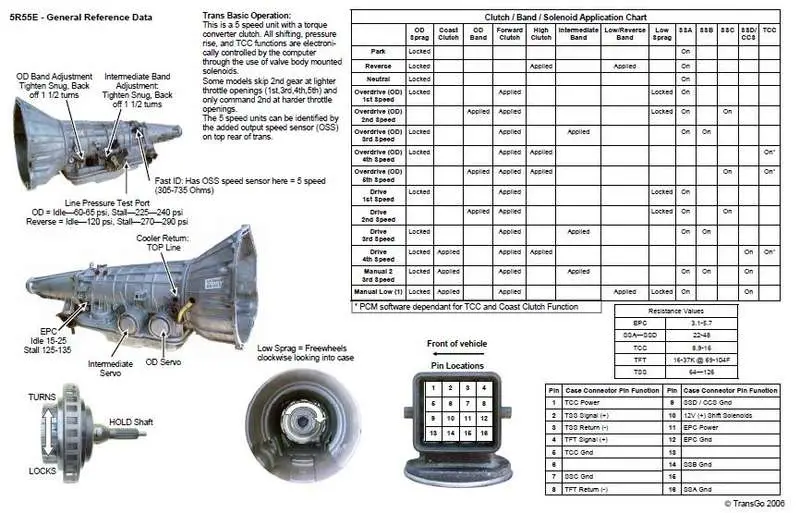

Well here I am again I think my transmission is toast. I dropped the pan and the valve to remove a double gasket on the valve body. Put the valve body back up made sure all the bolts are tight and boom everything that I had issues with was fixed. I kept checking the fluid and made sure it full, and then i took it on a drive, but after it warmed up boom 2 3 flare and no reverse when I got to Walmart. So I think she toasted!
