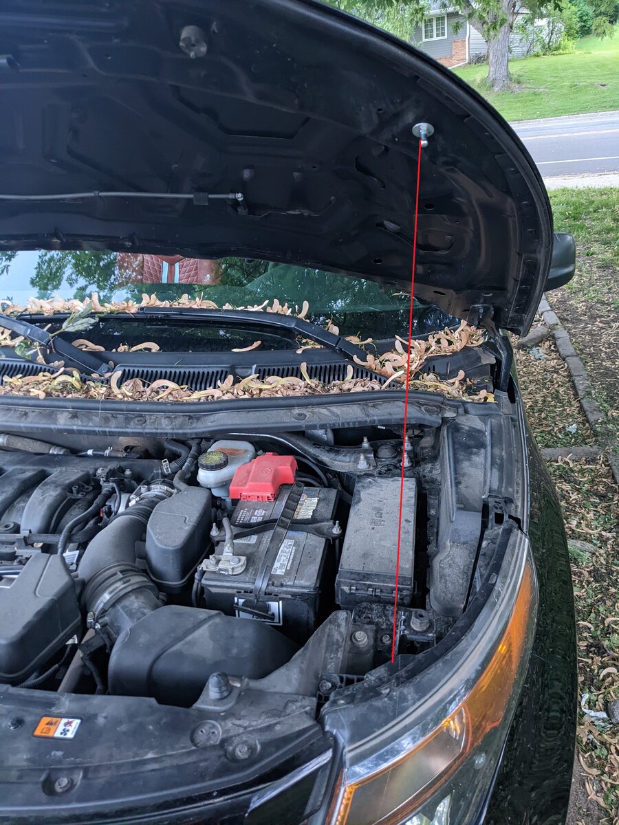

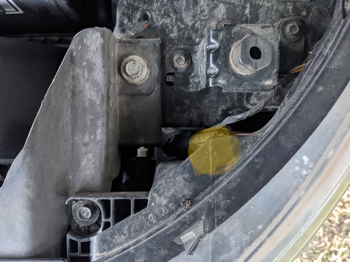

Here is the direction of the hood and the mount

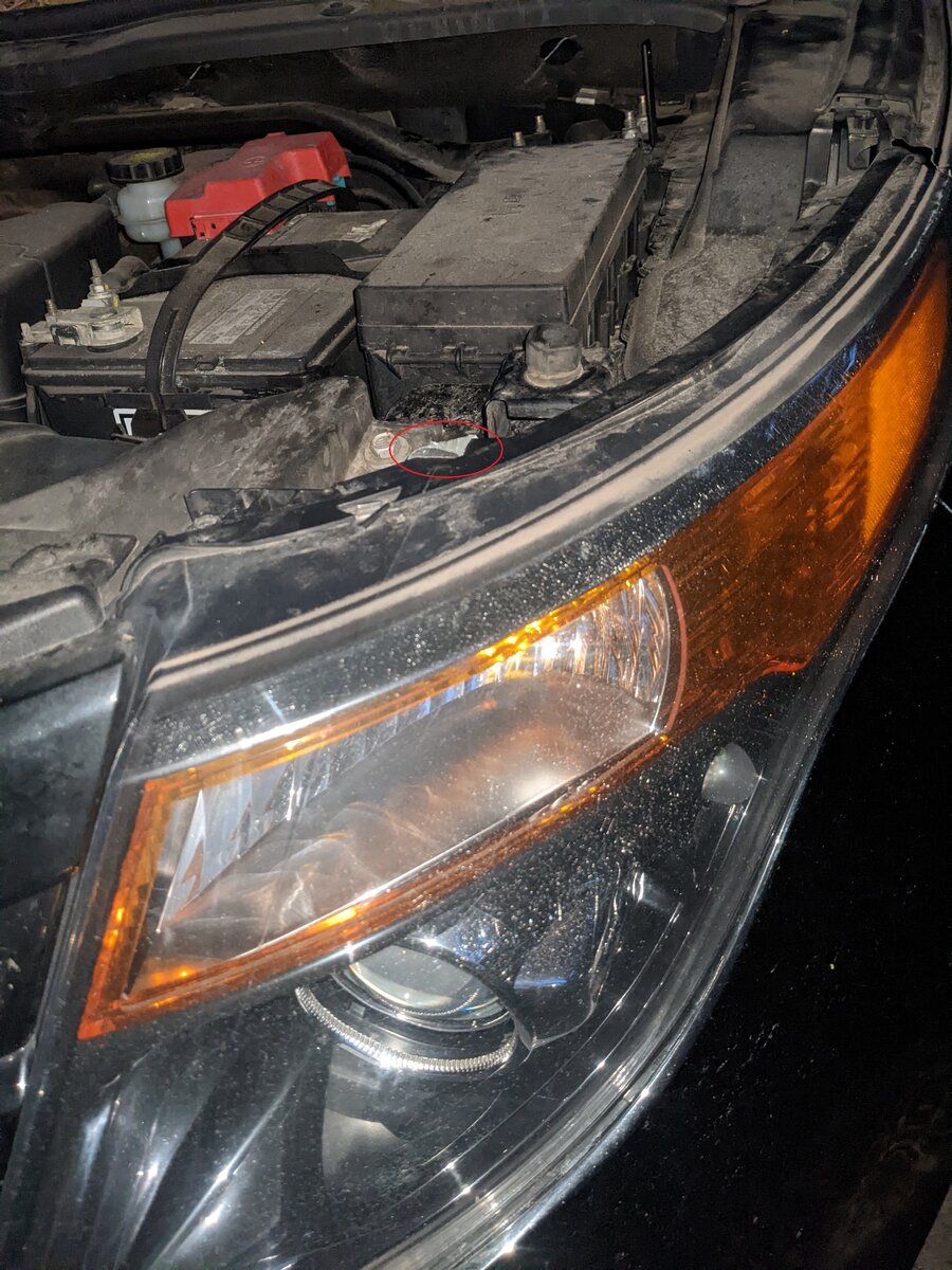

Highlighted is the area that is causing the mount hits.

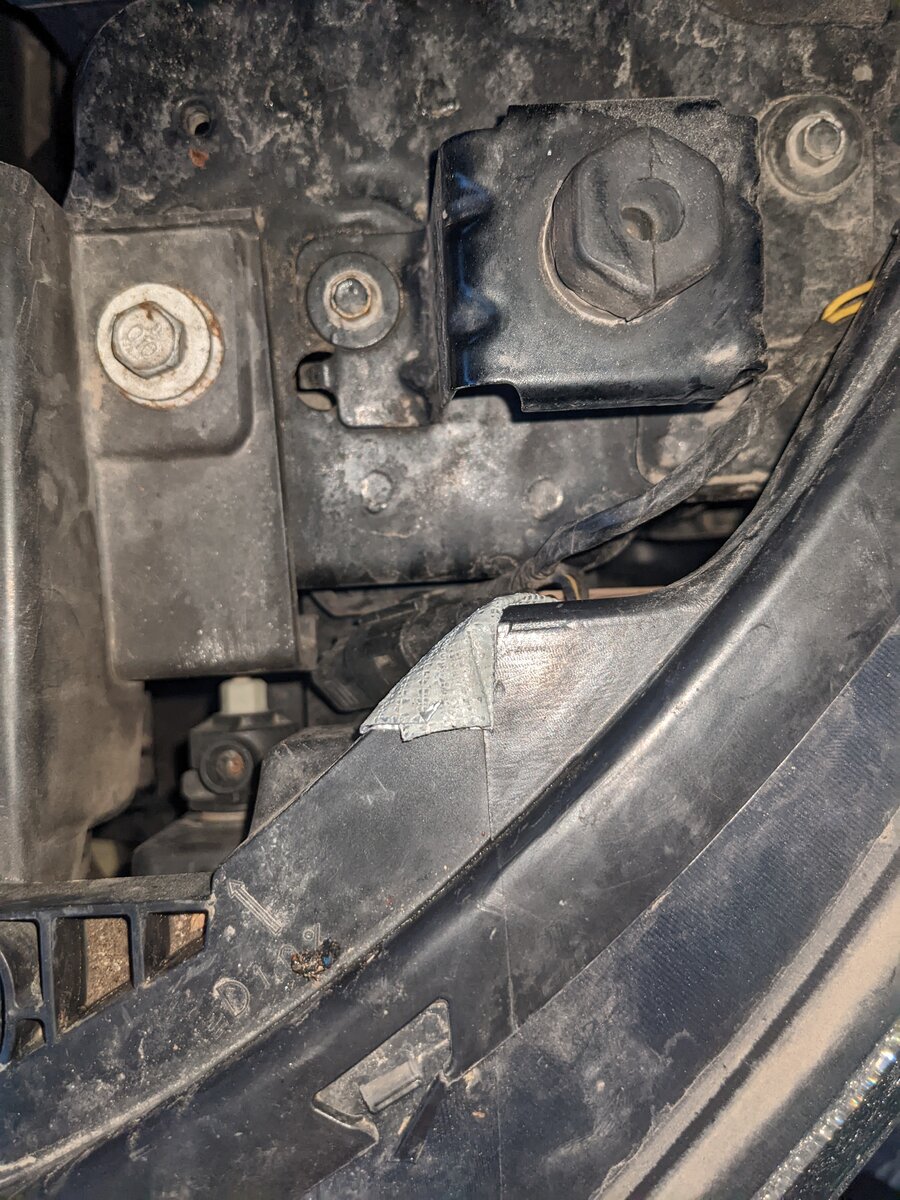

Here is tape over approximately what I'd have to cut off.

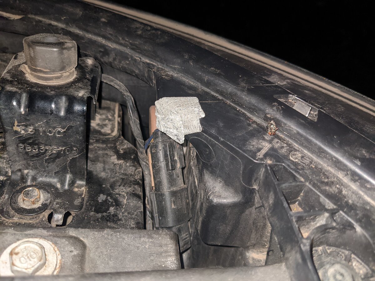

This is more of a front view, with the area circled.

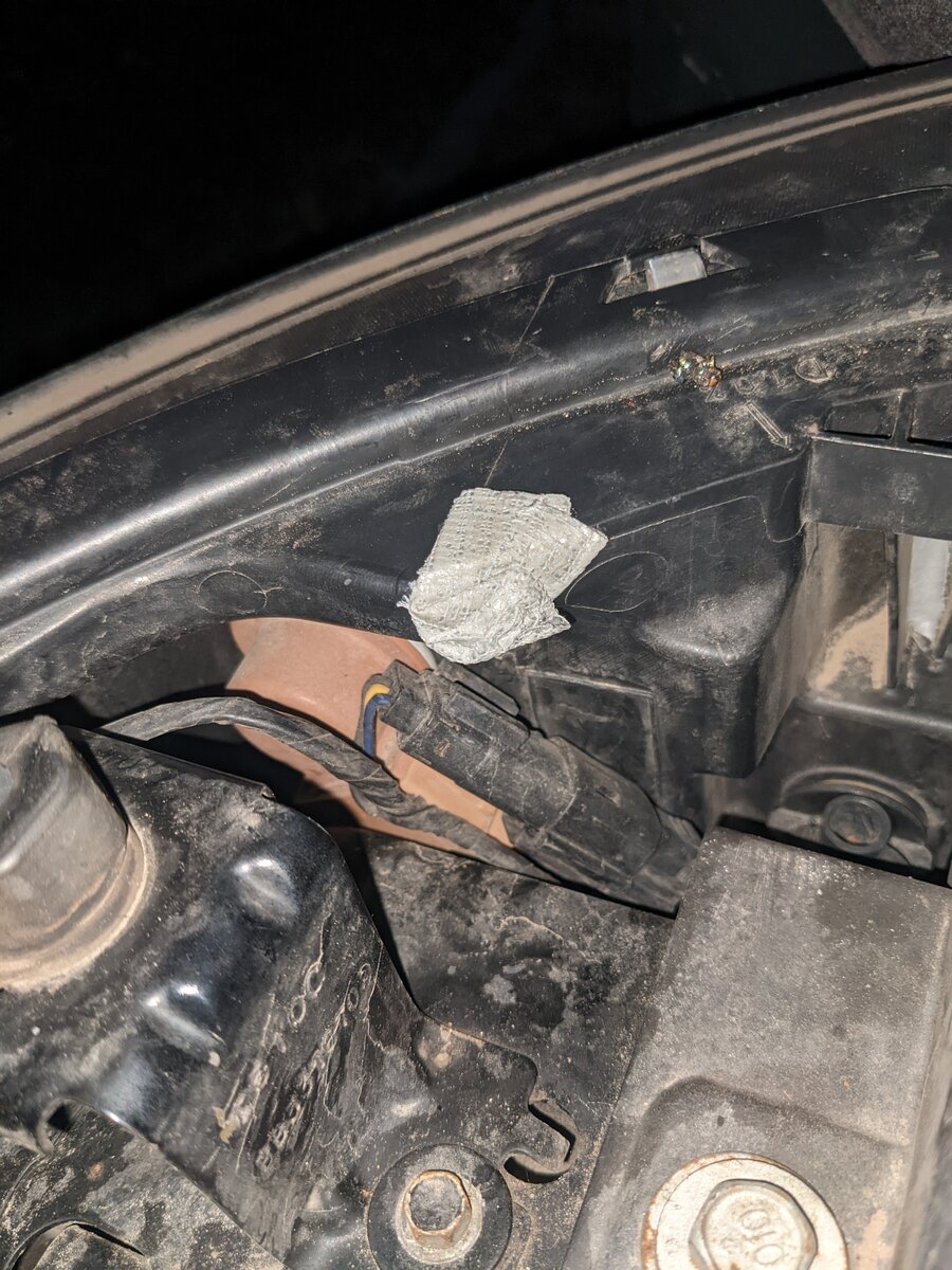

And I gradually move up to show exactly where...
And here are two additional angles of the area.
Any advice or help or second opinions on what to do would be greatly appreciated.

Ya, from what I can tell, I don't think it'll be a problem to cut...but you can't untoast the toast, once it's cut, it's cut.
As far as getting the right ones...I don't know that they exist? Redline and MRT make some, but they require drilling. If I'm wrong, please point me in the right direction! Thanks!

Why not just chalk it up as a failed experiment and get the Redline struts? Several members have installed them.
Peter
I installed Redline. No drilling. Just a cut to the hood pad for the stud. Been working great for over two years. I would cut my losses and get the ones that fit.
Peter
Because of my first listed issue, which is that there are stud mounts I had to put on the hood that would need to be removed to call it a day.
Removing these means either cutting them off or figuring out how to remove the female end from inside my hood so it's not rattling in there for the rest of the car's life, haha.
Oh, strange! When I was looking around, it looked like they only could be riveted in? The only other hesitation was that it'd be 4x times the cost for something I only kinda felt would bring usefulness. If I don't use this set I've already bought, I'd probably just not put struts in at all.
Although...looking at the pictures on redline...I wonder if I chose the wrong hood spots? There was no instructions from China, but I chose the only place that made sense based on the struts they sent. Maybe I can just cut off what I have, and locate replacement mounting studs?
I cut off the stud mounts and moved on with my life...if anyone has any ideas for how I could do it again with what I have...else I'll save for redline should I need em.
I have the Redline hood struts, not a single bit of drilling required. As mentioned, making a slice in the liner is all that is required. But I removed the liner, so it's nothing.
I am like, did I actually order a knock off Redline Hood Struts...? The real Redline Hood Struts need drilling? LOL.
I have them installed and like the others have mentioned, you only need to make a cut in the hood liner. Easy install. Works great.
