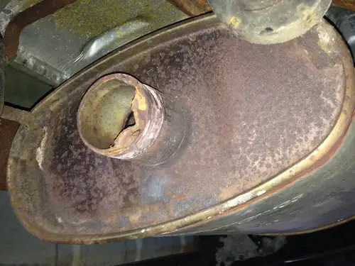

So I've hit a big of a roadblock in trying to replace my tailpipe. Unfortunately, the tailpipe rusted out and broke off at the muffler. I was able to get the connecting clamp off with an air cut off tool but the issue that I'm having now (and one that I guess I didn't even consider at first) is the fact that the the part of tailpipe that inserts into the muffler outlet is still stuck on. I snapped a couple pics to try to illustrate what I'm dealing with:
I wedged a screwdriver between the two pieces of pipe and banged it with a hammer and I seemed to be making progress but the leverage of laying on my back and the tight swinging space didn't help me out. As a guy without access to a vertical lift and limited tools does anyone have any suggestions on how to get the inside piece of pipe out of the outlet? I'm hoping to a.) avoid buying a new muffler too, and b.) dropping it off at the shop to have them do it. The new tailpipe is sitting in my garage so I'm itching to do this myself.
And your new pipe also needs to go inside? Maybe you could purchase an adapter to go over all you have remaining there, and connect your new pipe to that, shortening if necessary? Just a thought. If you must remove it you are doing it correctly. I once ground a flat screwdriver to a a slight angle then beveled the edge to cut, driving it all the way. You are heading down the right path, just got to get medieval on it, and don't forget the oil.
Hacksaw blade inside the pipe to cut a groove in the remains of the tailpipe; this will allow you to grab the piece of tailpipe peel it around and remove it. Spray with penetrating oil to help loosen it up

Slicing the inner tube, as Bill suggested, relieves the pressure since the inner tube can now get smaller. Then you can peel it inward. You still have to break the rust bond. A torch helps with that.

So I finally got the broken tailpipe piece out of the muffler outlet and installed the new tailpipe this past weekend after about 5 hours and many trials and tribulations :thumbsup:. With the help of a friend we got the rear up on jack stands and were able to place a propane torpedo heater right on the muffler. We got that sucker nice and warm and then with the help of some PB blaster and a lot of banging we were able to chisel between the two pipes and pulled the broken piece out with some vice grips. I thought we were good to go after that but then we found out that the old U-clamp had actually made a slight indentation on the muffler outlet which was not allowing us to fully insert the tail pipe to the muffler. So out came the sawzall and we trimmed the outlet just enough to allow the new pipe to be inserted securely on the muffler outlet. Even though it was exhausting work (pun intended) I gotta say there's nothing better than a successful DIY job!

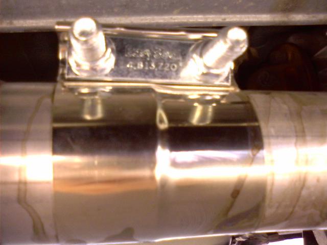

You might have had less headaches using a lap joint, or butt joint, stainless band clamps.
I used 2½" Torca TorcTite EasySeal stainless steel band clamps on my Gibson exhaust.
