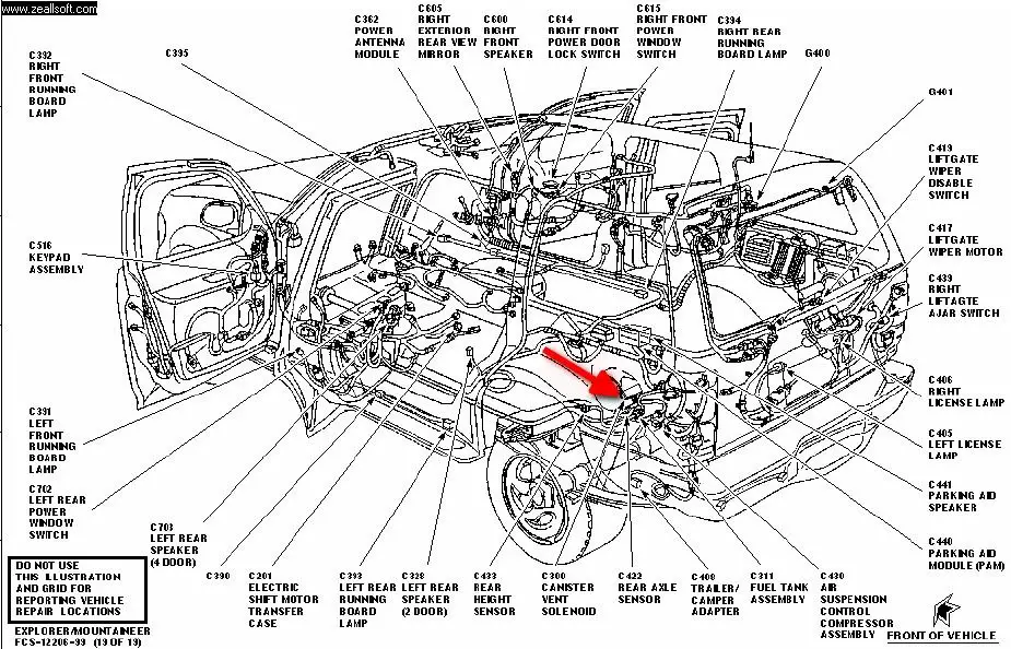

Here's some diagrams:
the solenoid is at the Red Arrow:
here's what the whole shebang looks like. the solenoid is laying close by the charcoal canister, (the two rectangular dudes) and is held in by a large plastic clip
the canister vent solenoid valve is 6 inches long, about 1.5 inches in diameter, with a half-metal casing and the rest polymer.
