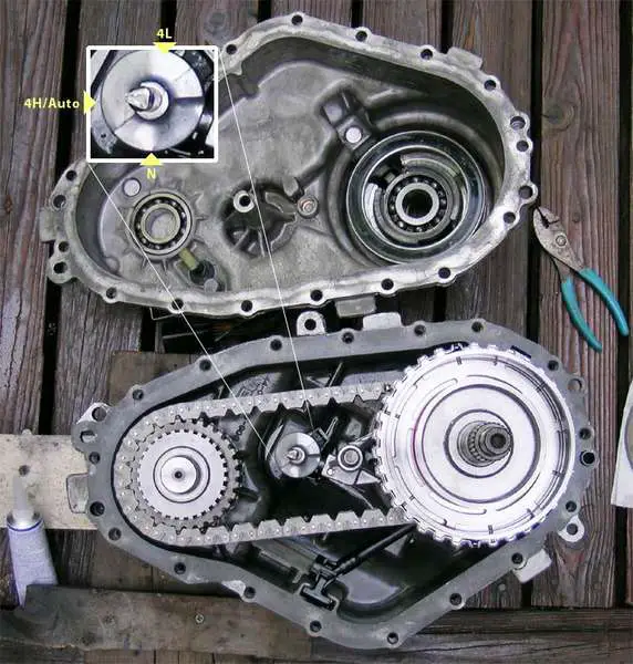

Okay never go to that dealer again because the 98 XLT can not be shifted back to 2wd from 4HI -- you can only do so if the vehicle is stuck in 4LO because the shift motor only controls HI-range and LO-range, not 2wd or 4wd engagement (see image below). Assuming you have a 4.0L engine (and not the 5.0L which came with a different transfer case), drop the front driveshaft and take it for a spin.
If you told the dealer that you unplugged the transfer case's electrical connectors, then they should know that it can not be an issue with one of the sensors because w/o electrical power, the transfer case (that comes with your 4.0L 98 XLT) will default back to 2wd -- unless there is a (internal) mechanical problem with the transfer case.

IZWack is right on the money here for all the reasons he's already mentioned. Whomever you spoke with at the dealership is incorrect (as usual). They are either unfamiliar with the system on a 98 Explorer, or just plain uninformed. If you unplug the connector on the transfer case, you have effectively eliminated all 4wd function. If you unplug the transfer case connector and the binding while turning persists, there is a mechanical issue with the transfer case (and it's not the shift fork).
Furthermore, contrary to what the mechanic may have written on the work order, you do not have a 13-54. All second-gen V-6 4x4s have a 44-05 transfer case.
