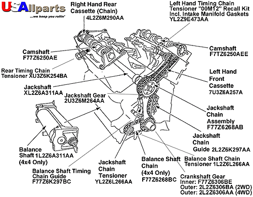

If you can wait a couple of weeks then you could order the rear tensioner and oom12 kit from tascaparts.com. They are a taexas ford dealership that will ship and they have great prices. Just remember to factor in import duty and vat but it still works out cheaper than uk dealers.
Below is a pick with the US part numbers so you can go on the tasca site to check prices

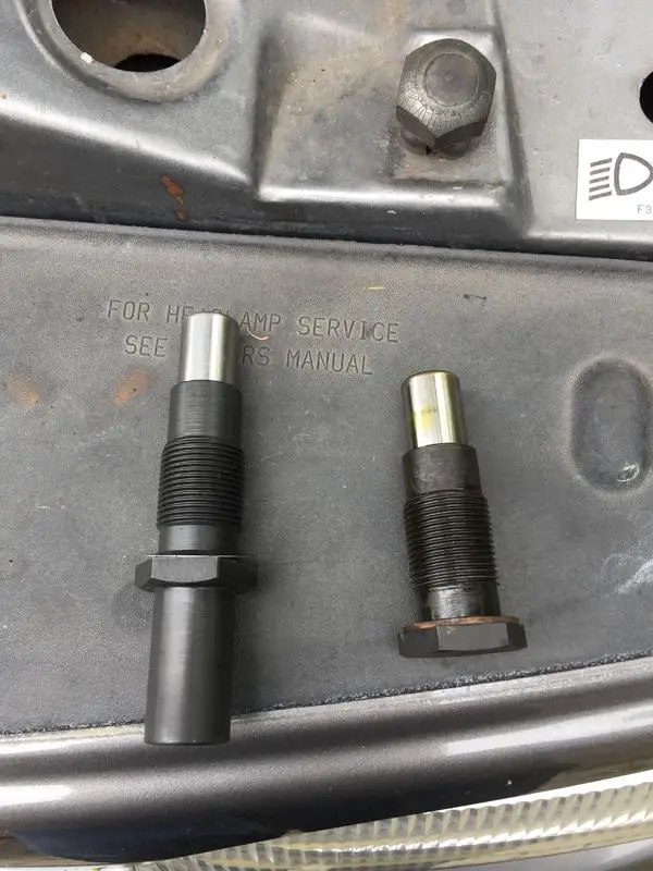

Well, it has been a while. So I ordered up my OOM12 Kit and Rear Tensioner and did a bit of a Bank Holiday project and fitted them yesterday.
I must say it was straightforward but a bit fiddly, although access to the rear manifold fixings was not as tricky as I had anticipated. It took me about 4 hours to do both jobs, taking into account a couple of trips to Halfords to get some missing tools I needed.
I was hoping to do a video or picture guide as I went along, but ended up just getting stuck in...and there is plenty of info out there. I just used the AllData instructions with no photos and it was straightforward, but I have watched plenty of videos and read more comprehensive instructions in the past!
I never had a distinct rattle on startup, but there was always slight noise which has now completely disappeared. Idle has much improved, again I never had a problem or warning lights but there was some evidence of very slight leaks round the old gaskets which were pretty solid. It is now so quiet and runs really smooth.
Installation of the rear tensioner was really easy, I reused the washer from the old tensioner and nipped it up to about 70Nm I think, and have checked it after a good run and all is well.
As I say, I didn't do a guide but here are a few random pics:-
