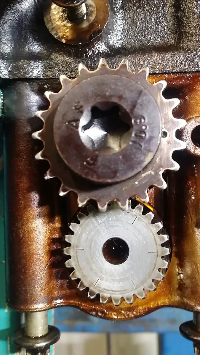

Hi, new here and need some guidance.
I am doing a tim
ing chain replacement on my 2010 Explorer XLT 4.0 SOHC and can not find instructions on how to calibrate the balance shaft to the crankshaft. On mine the top sprocket has one dot and the bottom gear has 6 small lines around it.

Yes I have watched that video several times. The balance shaft alignment marks are totaly different than the ones on my 4.0. I was hoping someone has seen this one before.

Here is a little better shot of the markings.
On the sprocket there is one dot not two lines, and on the bottom gear there are six lines evenly spaced every 4 teeth not one dot. And as you can see the gears are in front of the bearing housing not behind it.

I did spend some time searching google and youtube for a procedures but found nothing. I only found how to time the one without the gear teeth. I may be worth a shot to pay for an alldata diy subscription (only need a month) just to see if they have it.

So your saying that I can just remove the balancer? Or perhaps just remove the chain?Will there be any problems afterwards?
Just remove the chain pop a link
No problems reported that I know of
Leave the balancer itself in place
