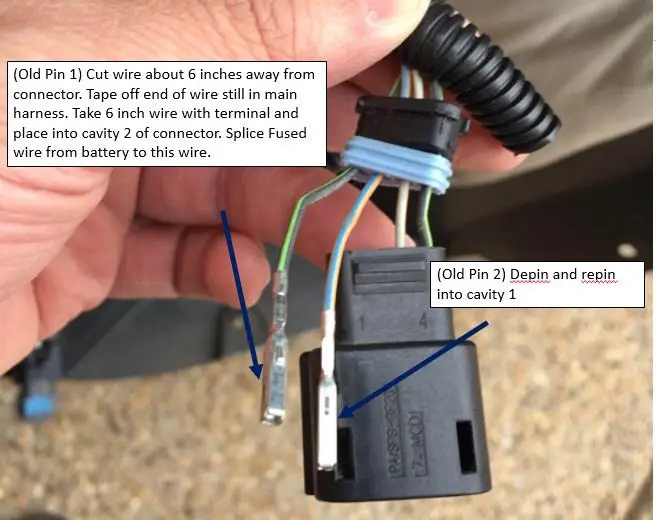

It was only on the 302a Limited. There was a member on here that I helped retro OEM HID housings in his 2014 sport. Just had to swap a couple of wires and add a ground for them to work with the factory harness.
HELP - Explorer 2015 OEM Limited HID headlights for 2014 Sport
