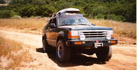

TJM makes bumper that hides the winch completely as long as the winch is a low profile. I have the TJM T17 with a Ramsey REP9000 and the only thing shown are the roller fairlead and the hook.

Do a search on the site for TJM and you'll find the website. I can't remember where or what it was. I haven't even try to post a picture on here so I don't know how. I can e-mail you a picture of my front bumper so you can see.
Here's a picture of Khoa's truck
Ray :)
