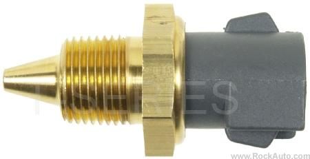

All sounds like a bad PCM temp sensor.
Hard starts when warmed up = PCM temp sensor. ("thinks' it's cold all the time)
Intermittent high idle = PCM temp sensor ("thinks' it's cold all the time)
Injecting too much fuel at idle.
Yes, I read the part where you said you replaced it. Doesn't mean it's good or the correct one. It happens.. .. ..
Always disconnect the batt for a couple mins after replacing any engine/emission control device to reset the PCM so it will "relearn".
These old OBDI computers do have "adaptive" tuning (All be it limited) and just like any computer sometimes it just needs a reboot.
I also noticed you say the gauge is working then two sentences later you say it's not.
May be you put the sensors in the wrong holes, or mixed up the wires..?

FR-425, Sorry for the confusion. The temp gauge is working and has always worked. The fuel level gauge is the one that's not working right now.
Ill order a new ECM temp sensor along with the sender needed for the oil pressure gauge mod and probably a new fuel pump while im at it. might as well get it all so I don't get hit with shipping.
any particular brands I should stay away from or use?
No, just be sure that part number you order is the one you get.
I bought Motorcraft from Rock Auto, but it looks like they currently don't have any. (EDIT: it is Motorcraft but I got it local at Oreilleys')
You may have to call to see if they are going stock any more.
I guess my next choice would be the AC Delco.

Duh... can't cross up the wires huh, one's a plug the other is a push cap... my bad.
Motorcraft is the best for sensors, hands down. Looking at rockauto, there is nothing wrong with airtex/wells or standard motor products.
