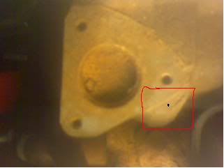

I just bought a '97 XLT in immaculate condition for $800.
Only problem is it's got a pin hole in the rear of the left head.
The pic is not the offending item it is from a spare engine I have in the shed.
Any ideas on how to patch this up without pulling the engine or the head.
I'll swap engines if necessary but rather not if I don't have to.

Is the hole in the oil passage or coolant passage?
Honestly, a head swap would be the correct way to fix it.
That's what I was thinking- and I think that's actually a '98- even better deal!
definitely coolant the intake is off and I've seen it spout out.
If it's a case of pulling the head I'll prob swap engines.
If it's just a pinhole and the surrounding area isn't weak,have it welded shut.Back in the day they would weld cracked blocks so I know it can be done.That is of course if you can access it to do so.:D
Also if you can access it and want to do the cheap way,drill and tap it and put a set screw in it with sealer on the threads.Sounds stupid but it works,it all depends if the casting is relatively solid except for the pinhole.
