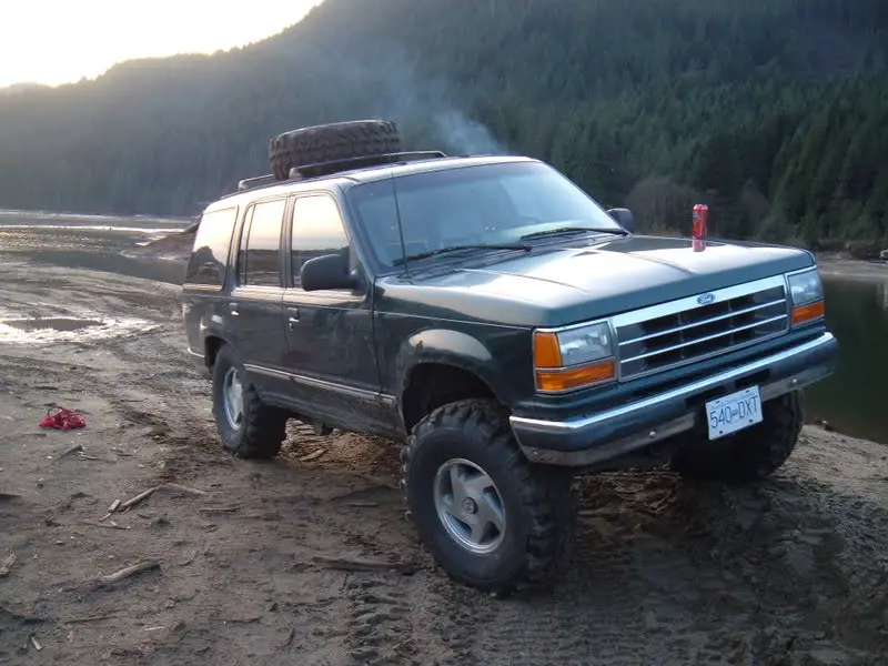

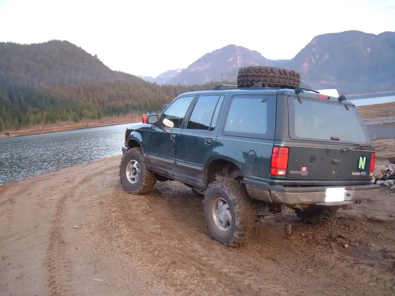

I got rid of the BII and have now started to build up my ex. It was 100% stock. So far in the last few weeks I have added body lift and 33x12.5x15 swampers.
1994 XLT 4 door auto. Transmission has just be rebuilt. 3:75 gears and limted slip 8.8

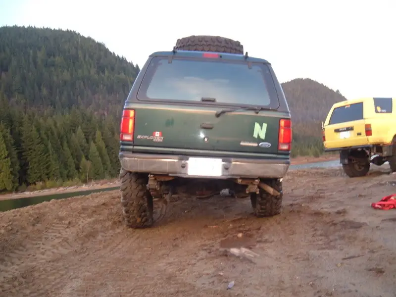

I have a few plans for this, but first need to level out the truck so I am making new rear shackles for the rear.
this is on a hill facing up so its not as bad as it looks as far as sagging goes
