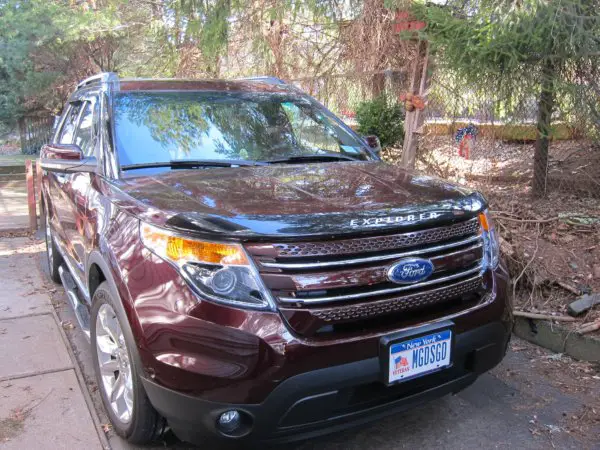

I just installed one of THESE on my wife's 2013 Limited. No clips, screws, nor a place for leaves, debris or frozen snow to collect. I have never liked bug deflectors which flap about, clips brake from vibration, and eventually rub away the paint.

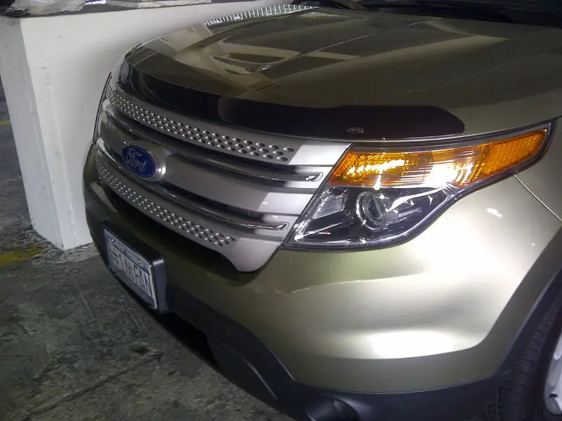

Found this in the 2012 explorer brochure from dealer and I like how it wraps around the hood and stops at the edge of the headlight. Any that I have looked from aftermarket suppliers stop in the middle of the headlight. Does it exist? Thx for all help
Yea, the factory one is shorter like the one in the link, but I'm with you, I like the one in your pic better :thumbsup:
almost all of the pictures in ford catalogs are photoshopped.
