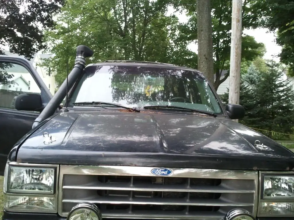

I never messed with that hood release latch, i found a set of locking hood pins for 25.00 they aint fancy looking which is good for me, because then you dont see them as your walking by. so bascially installing them is like installing a bolt, shut the hood, have it marked above and drive through both at same time.. maybe ill get them and just be done with the mess.
im gonna go look under the hood at that suport to see how hard it would be to get another tool inside it... i look at the kit and it looks simple
update; talked to a racing friend of mine, he said since its the old steel hood and not a fiberglass and i wanna use hood pins strictly with no hood latch and want a locker he recommended 4 standard pins and a locking pin to bare the weight so will do so in next week or so, try to remember do a write up w/ pics
Ok they are in, all almost done, got to dark and need extra set of hands, just bottom nut tomorrow and all done. Oh and 2 "pretty" screws since I broke a bit.
Heres what they look like
