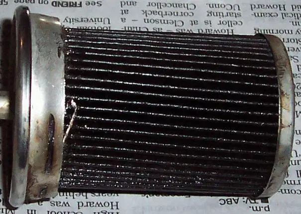

Now back in Vegas. The heat is not quite what it was when I had left, more hitting early 90's every day. However, I went ahead and changed the fuel filter. I've tried driving it pretty hard for an hour at the hottest part of the day and....so far so good. Not even a hint. Im not sure if the weather just aint hot enough to bring up the same problem, but the fuel filter was a mess. If this has been the source of the problem all along, could I have done damage to the fuel pump? This forum has been great.

I have no proof but it seems reasonable that a restrictive fuel filter will shorter the life of the fuel pump. As I recall Ford recommends replacing the filter every 30K miles. I suspect my 2000 filter was the original one when I purchased my Sport in 2009 with about 150K miles.
Have you ever tried breathing thru a straw?
It's possible pumps are designed for certain resistances. If you run it in a system with more resistance than it can handle I could see it being bad. I can't say for sure but I like the theory as well.
