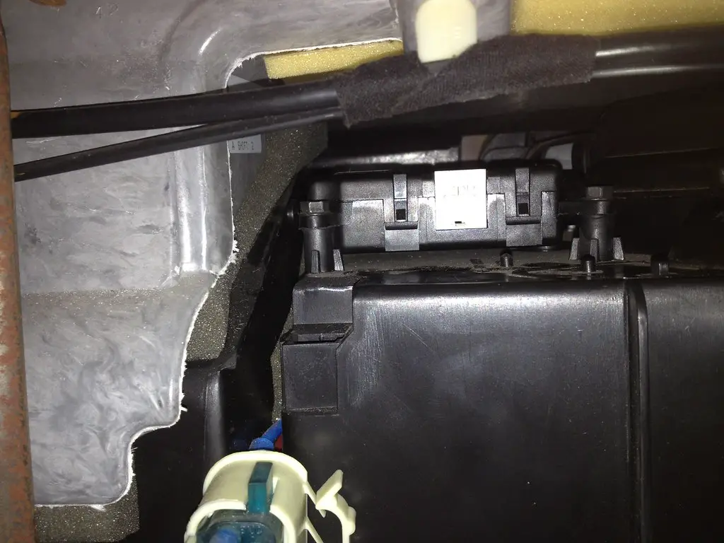

I am trying to get the actuator of blend door off to check whether it works or not. My A/C blows less colder air and I am not sure whether it is due to the blend door or lack of freon. So first I would like to check the blend door. The actuator is fixed with three screws. Two are in the front which you can see from the below picture. One is on the back. I wonder what kind of the tool I can use to get the back one unscrewed. The clearness from the top is only about 1 inch and half. I tried all hand tool I have and nothing seems to work.
Some say that the actuator can be pryed off but unfortunately mine is not the case.
