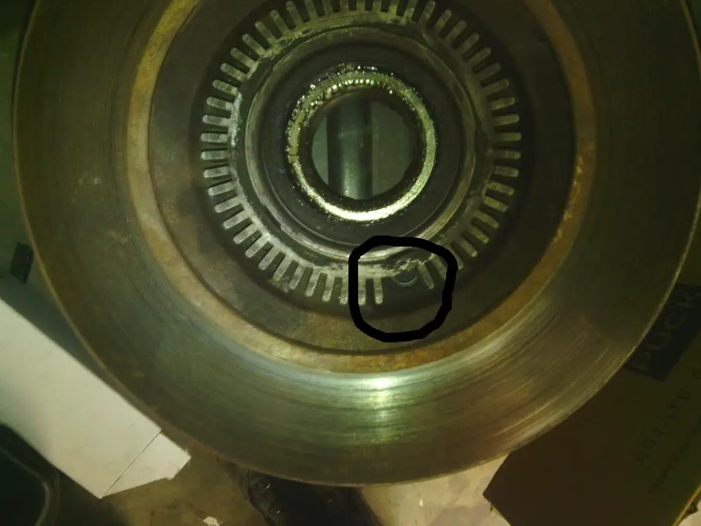

I have a spare rotor that I have broken off a couple of the signal vanes. (see image)
Install this busted rotor temporarily, and drive the vehicle "slowly" around the block applying light pedal. (doesn't matter which side)
Each time the gap passes the pick-up, the ABS valve will pulse.
You'll hear it, clunk, clunk, clunk.
20- 30 clunks does the deed, to get the air past the ABS block.
Then bleed as normal.
Install your good rotor and your Done! ;)
