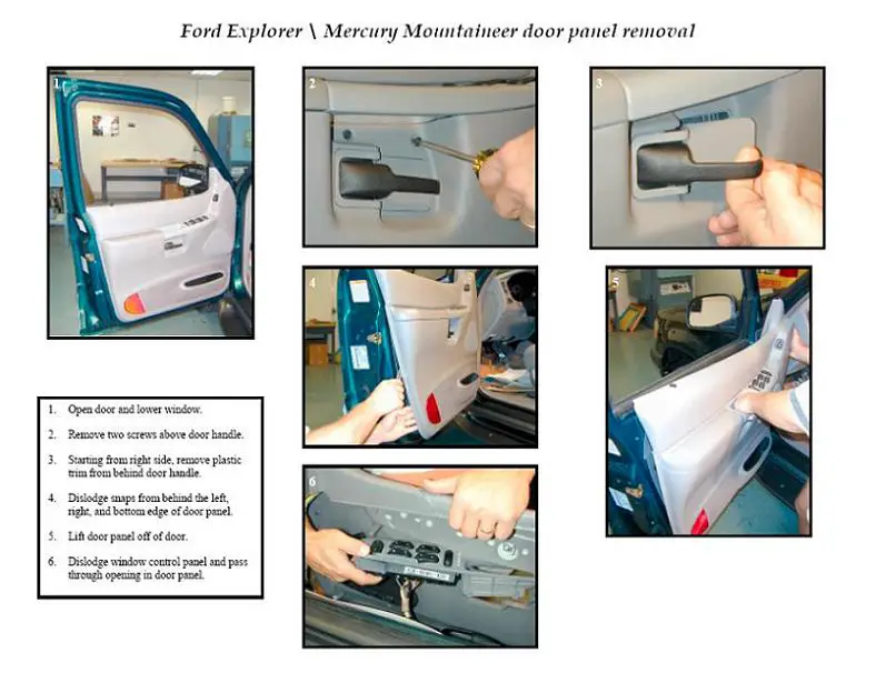

Yep this is about right but also there is a hook of plastic on the inside of the door card near the mirror
To release the switches console from the door card depress the little tab on the back underneath at each end shown below

Oops, I have manhandled the switch panel out and removed the 2 screws.
Anyhow, so it's a bit of brute force around the edges with a broad bladed driver to pop the very tight clips.
Cheers guys.

Cheers Howard, been looking for that.
