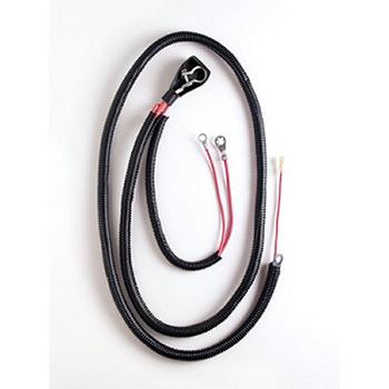

Are these right? These came from the autozone website and it says both are OE.
