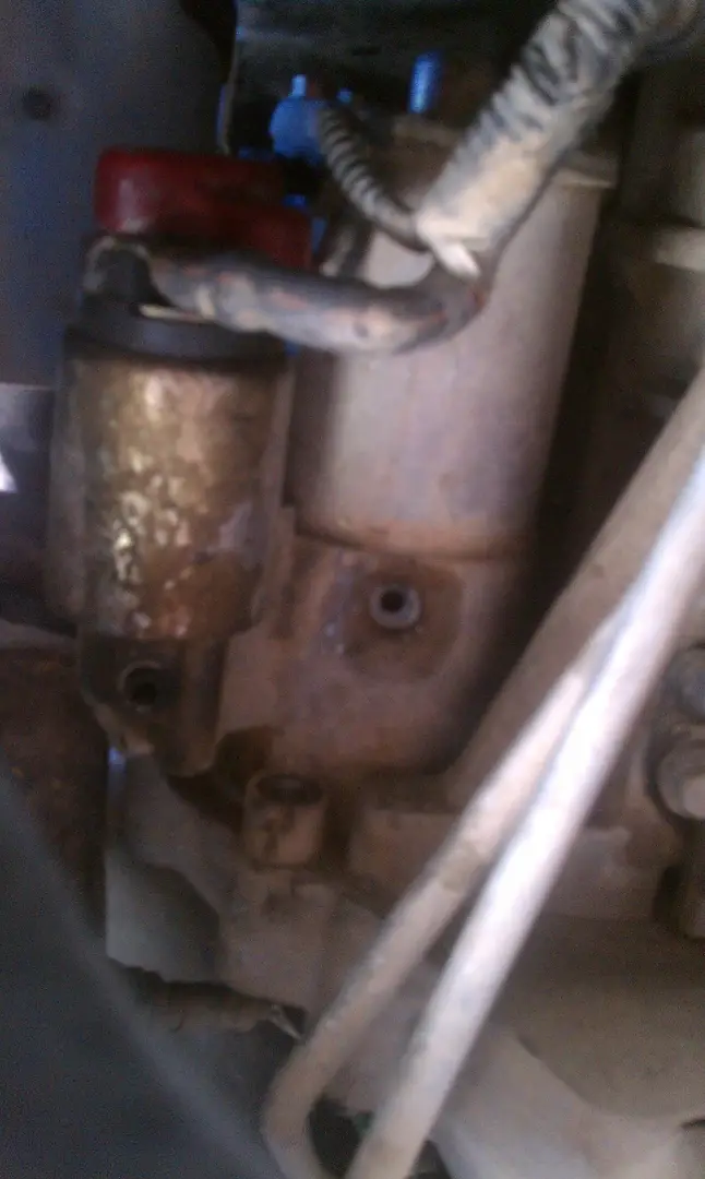

I have a standard four door non sport trac 4x4 v8 automatic that needs a new starter motor. I got the bottom two bolts out, but there's a bolt all the way on the other side of the starter that is completely inaccessible. How do I get it out?
The problem is that there is what appears to be a motor mount in the way. I think a stubby wrench MIGHT get it but I don't have one, or a wrench bent at an extreme angle on the handle in two different places.
Please help!
You didn't say which engine it is but if it is a 4.0 sohc then there are two bolts one on the bottom and one on top about 180 degrees from the bottom one. On the 4x4 you may have to either drop the front diff a little or unbolt the motor mount on that side and raise the engine to get enough clearance to remove it. The top bolt can be approached from the wheel well after you remove the wheel.
Okay first of all, he DID say which engine he had right in the beginning of the first post. He has a V8, not the 4.0.
Second, you don't have to unbolt the motor mount OR drop your front differential to get it out. Sure, it's a PITA.. It's more tedious than anything.
Go to advance auto/napa/whatever and tell them what you're doing. They can pull out a new starter to show you exactly how the bolt goes and they sell the goofy angled wrench you need. Then just get under there and screw with it a bit and you'll get it....
Brian is correct. Loosening a motor mount bolt or whatever else is unnecessary.
This bolt is commonly referred to as the B*TCH BOLT. Some folks leave the bolt out when they put everything back together. I always put it back in myself. I use one of these to help me:
http://www.harborfreight.com/3-8-eighth-inch-ratchet-with-indexable-head-96092.html
Other wise, you just use an open end on a combination wrench and get spin it about an 1/8 of a turn at a time.

That wrench would do the trick.
You can also get to it through the wheel well (tire off), with long extensions and if I recall correctly, a U-joint. Reach in from in front of the strut tower.
I just replaced the starter on my 04 V8 4x4. I used 2 of these wobble extensions and a few straight extensions for both the top bolt and the middle bolt. Access from the wheel well (literally turning the ratchet in the wheel well) in front of the strut tower. Never removed the wheel. Very simple way to do it. Hardest part is finding the bolts with the socket. Once your on them there is plenty of room to wrench.
