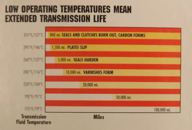

High temperature is bad for the transmission as well as the engine.
What is too hot for the a4ld? I added a temp gauge the other day with the sending unit in the pan. Around town/highway a/c on it will stay around 140-160. Last weekend I took it up a long, very steep dirt road in 2hi. The temp climbed up to 220-230. I assume that is way too hot??

# 8 in my list of useful threads has transmission temperature charts. Here's one chart for example:
