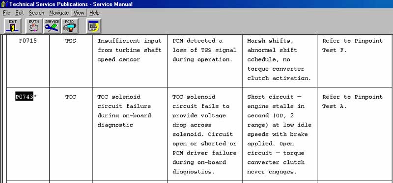

From 97 Service Manual:

hay dogfriend will that say the same thing for the 5speed auto
That code is for the 5R55E (5speed Auto)
The code indicates that there is an electrical problem with the shift solenoid. It is possible to replace the solenoid without dropping the transmission. I'm thinking that if you only need to replace the solenoid, it should not cost more than a couple of hundred $.
