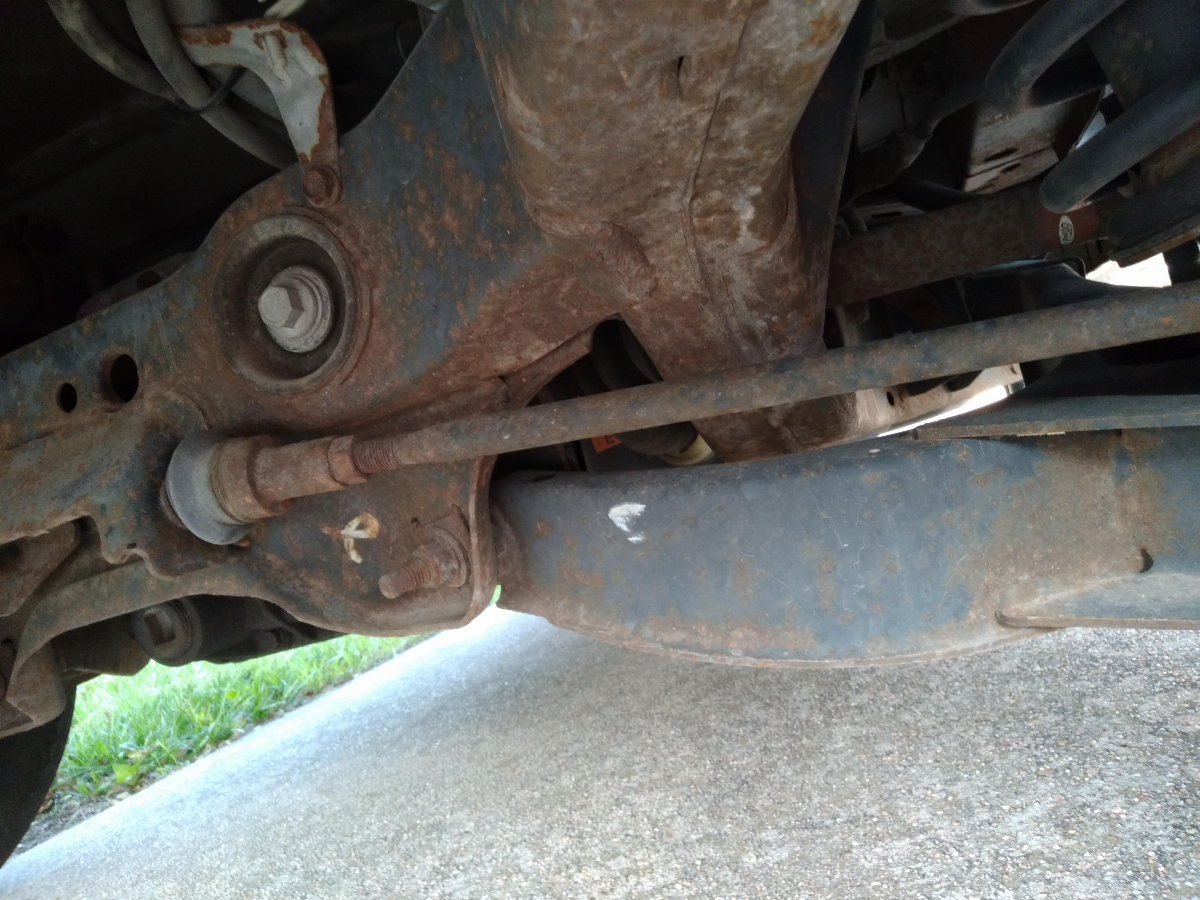

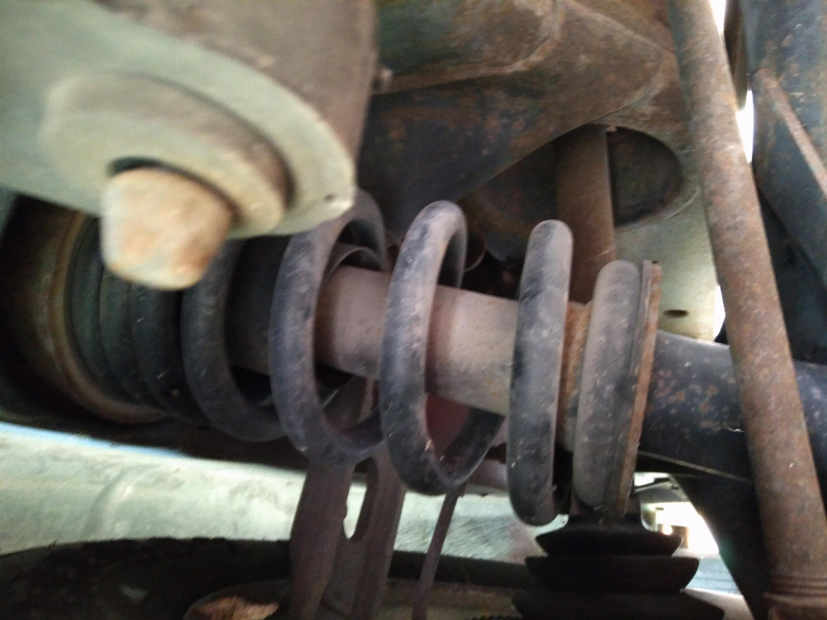

I have included some pictures of the rear-suspension while I was out there.
Typically a P radial will ride nicer than an LT or AT tire. I’d assume the struts would need replaced if they’re still factory. You might want to look up the spring code on your door and see if you can get a softer set.
Preassembled struts are a gamble as far as the spring rate.
It looks like MOOG sells a variable rate spring for these. That would likely ride better, without sacrificing all the capacity.
Struts don't normally seize, but then vehicles don't normally have their rear end get tighter over time either.

If you have a hydraulic floor jack you could jack up, put in your jack stands, and remove one of the rear tires. Then move the jack to under the control arm where the strut bolts in. Use the jack to lift the lower control arm and watch the strut. If the strut rod shortens as you lift then it isn't frozen. If only the spring compresses and the strut rod remains the same length then you know what the issue is.
You probably have to do both sides to be sure. If it is frozen, you might be able to free it up with the jack in the same way but it would need replacing.
It seems more likely that the strut has collapsed from loss of compression than frozen. Is your rear end riding low as far as you can tell?
