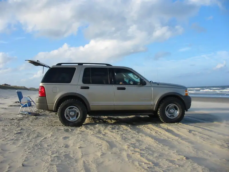

Here you go:
Keep in mind that those older wheels have over an inch less backspace. I think 285s would be real tight on the inside with the new stock wheels.
