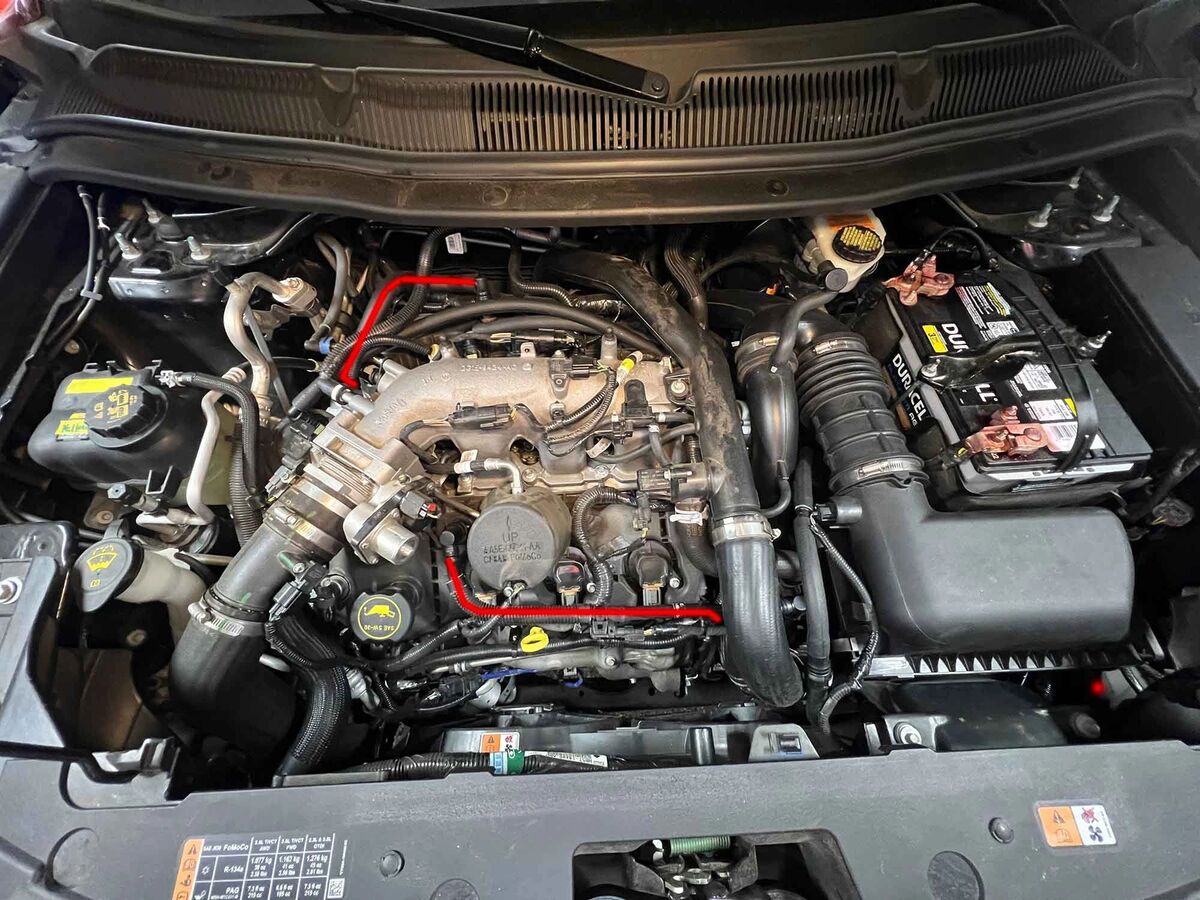

These are the 2 hoses you will use on valve covers.

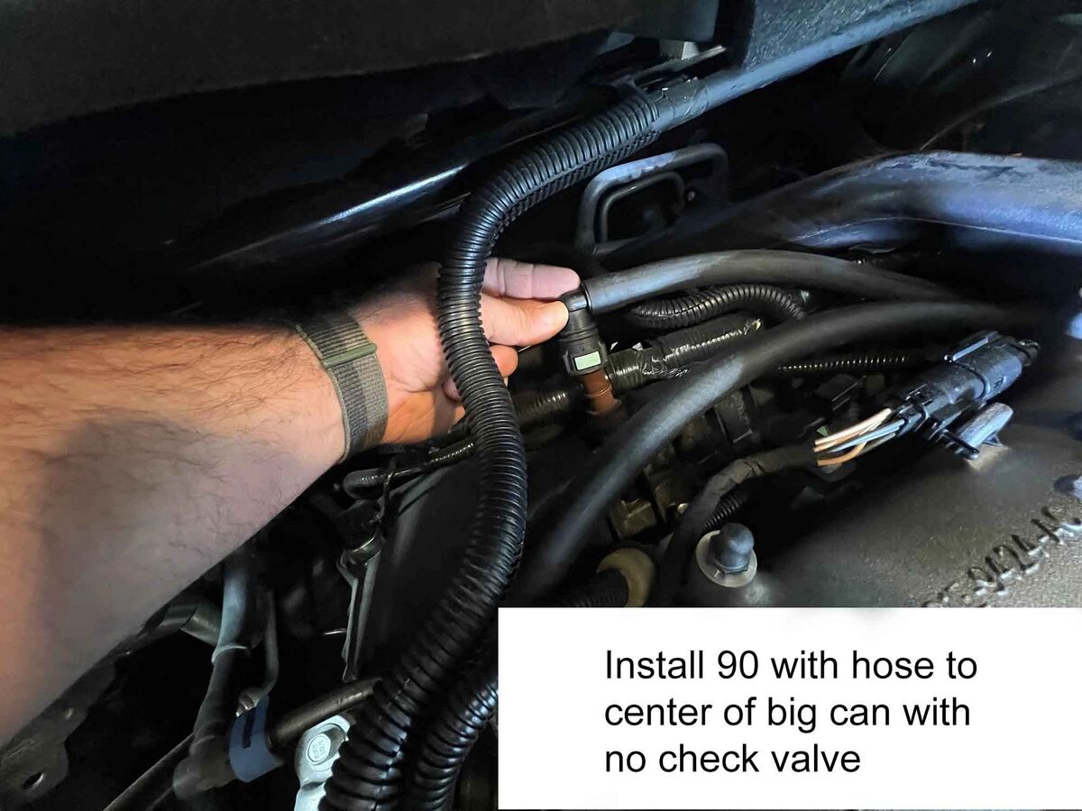

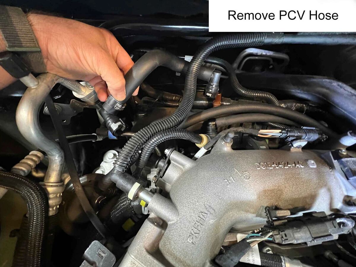

Remove PCV hose from intake and valve cover
Install a 90 degree fitting to the valve cover PCV and run hose under ducting, master cylinder, and battery around back of air box cavity into fender cavity where you can mount the cans. This line has no check valve and mounts to center of the big can.

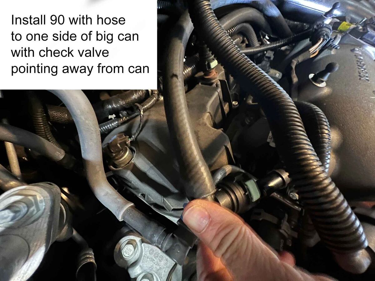

Install a 90 degree fitting to the intake and run hose along same path as PCV hose above. Add a check valve somewhere inline and point it away from the can. I added mine under the airbox and did not have any clearance issues. This line mounts to either side of the big can.

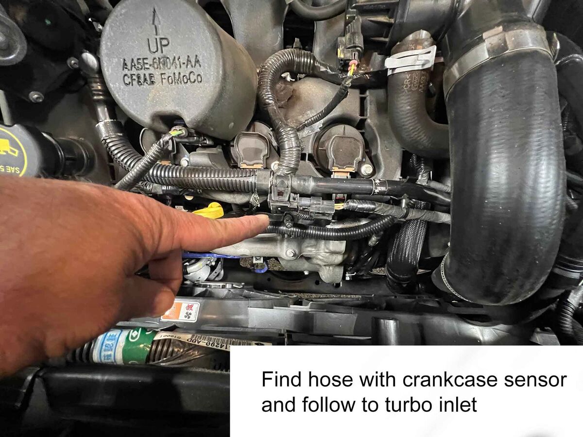

Follow the hose on the lower valve cover with the crankcase MAP sensor on it, do not need to disconnect.

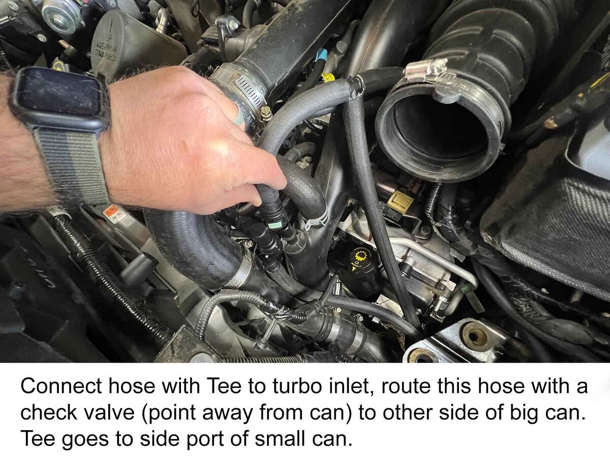

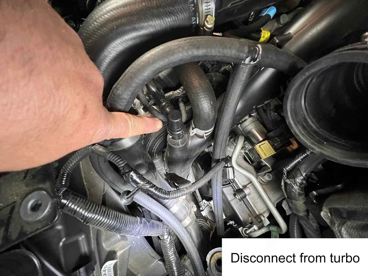

Follow to the driver side turbo and disconnect the inlet.
Install a straight fitting on the turbo inlet and a section of hose then install a Tee fitting. Continue the hose under the air duct and battery, behind the air box cavity following the same route as the other 2 hoses from the PCV valve cover. Add a check valve inline somewhere, pointing away from the can, I added it in the same place at the back of the air box cavity but a few inches away from the other one to minimize vertical height. This line mounts to the other side of the big can.
Install a hose to the Tee that routes beside the transmission and under the frame rail to the side port of the small can.

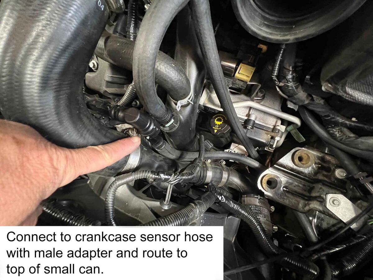

Install a straight hose adapter to the line with the crankcase sensor that was connected to the turbo inlet. Run the hose under the air box mounting plate and around to the front of the cavity then down to the top of the small can with a 90 degree adapter.

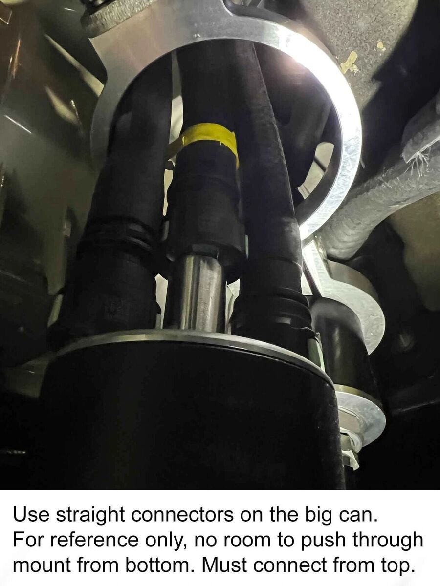

This is for reference only: The kit came with all 90 degree adapters for the top of the cans, but there was no room to install them, so I got 3 straight connectors for big can and had no problem with space. I'm showing the connections here, but there is not enough clearance to push the can into the mount from the bottom. So cut the lines to length and install the adapters, mount the can, and install the outside 2 first, then the center. (No clearance if you mount center before sides)

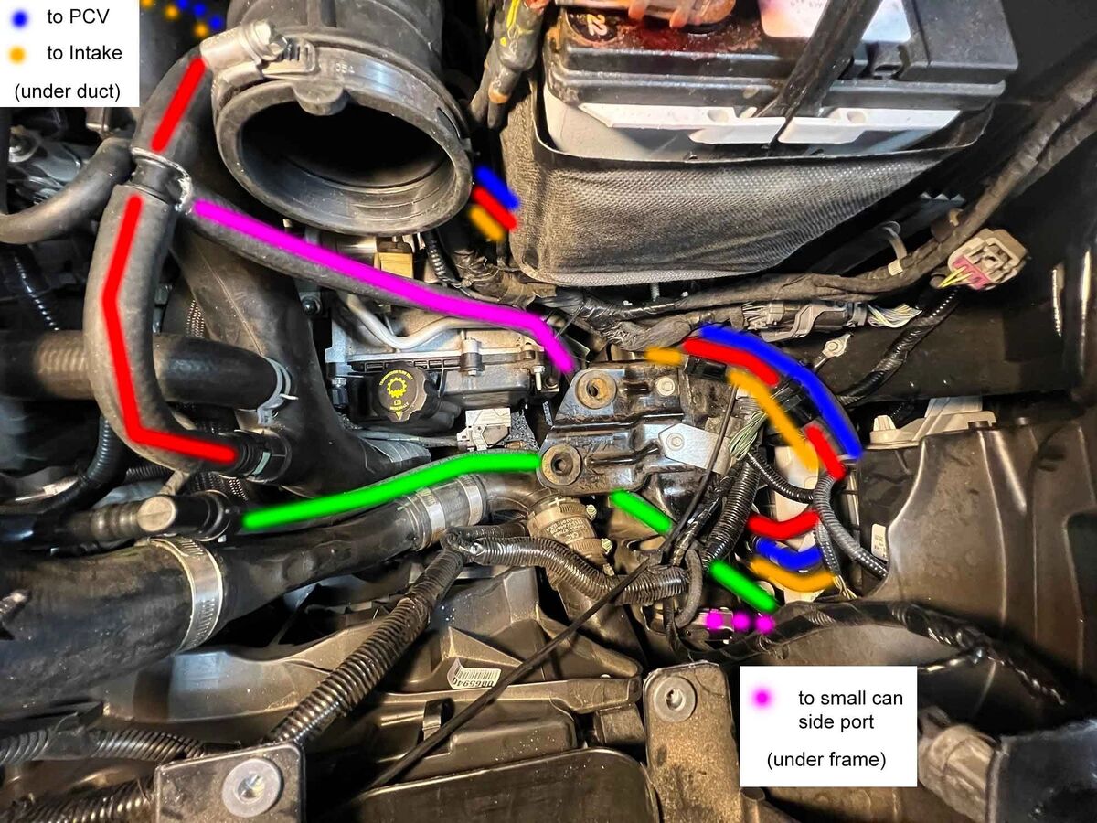

I made a legend to show the routing of the hoses.

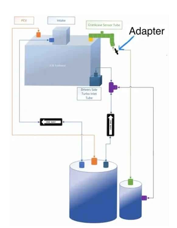

Here is the diagram from the website teamrxp.com, there were no instructions in the box, but with this diagram it is very easy to follow and setup. The hardest part is cutting the hose to the right length and routing it to avoid interferences, etc.
