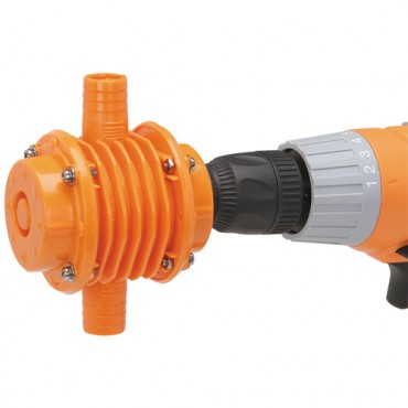

I have a drill powered pump I found at Harbour Freight tools I was going to try. It's not the type you connect a water hose to but a 3/4" or 7/8" hose.
