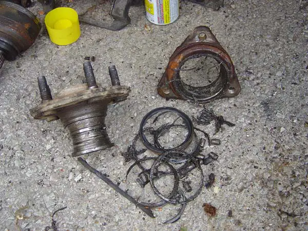

If they do this when you pull the wheel and rotor off it might be time to replace them. (No, I did not pull it apart, all those pieces just fell out of the knuckle when I unbolted the caliper mount) :p :D

WOW
:eek: :eek: :eek:
Yeah, you might want to think about replacing them before that. ;)
Stretch, so others know what to look for, what were your first symptoms, and how long after them did you continue to run it? I always replaced them as preventative maintanence because I never knew what they would do when they need to be replaced.
Jefe said:
:eek: :eek: :eek:
my only symptom at first was a very slight scratching sound coming from the wheel well. it sounded like the wear indicator on the brake pads, and thats what i assumed it was. the sound was only there for about 4 days though before things got bad inside the bearing.
now that i know what the problem is, here is the easiest way to diagnose:
jack up which ever wheel you are trying to test. grab the tire from opposite sides. with one hand push the wheel away from you, and the other, pull it towards you.
your wheel assembly should have very little angle movement. if your bearings are going bad, there will be a lot of play in there. try comparing the two front wheels, that was how i knew for sure that mine was bad.

I did not get to much warning because I wasn't driving it for about a week befrore the hub went. My front R&P gears were popping and grinding real bad and since I'm in the process of a D44 build up I decided I would just convert to 2WD using Jefe's method of using the outer stubs of the CV axles to hold the hub together. When I drove it to where I was going to do the work I noiced that my ABS light was on and wasn't sure why. I took off the driverside wheel and saw that my caliper was only being held on with one bolt and wasn't sqeezing on the rotor at all, just the air. Well, there's my ABS problem, I thought. So I got a new bolt and replaced it an finished with the 2WD conversion. I take it out for a test drive and while I'm out I hear what sounds like the brake wear indicators, the normal squealing. I'm thinking WTF? I just replaced both pads and rotors up front about a month ago. I got less than a half mile from my house and this awful grinding noise starts coming from the front passenger side. I didn't get 100 yards farther down the street when my front end dropped down toward the passenger side and about caused me to wreck. When I got out I saw my wheel was severly angled in at the top. After I jacked it up I could move the wheel in a side to side motion and saw that the stub axle was moving right along with it. Between that and the bearings all over the gound I figured out that my hub had gone. Obviously, I was right about the hub being bad. That was this past Saturday, by Thursday I had it replaced and everything's good now.
So, I guess the warning signs I had were:
1. ABS light came on
2. Squealing from brakes
3. Grinding sound from up fornt/Play in lateral movement of wheel
4. Wheel bearings all over the ground :p
i had the same scratching that i assumed was the wear indicator, then (lucky for me) the hard grinding was heard when i first started moving the truck one time, so i was fortunate enough not to be driving. stretch, you're lucky you didn't crash when your front end dropped like that. when i heard those terrible scraping noises, i decided immediately not to drive it.
