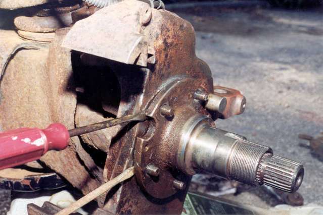

How manual hubs work...
When you press the 4x4 button the shift motor (upon receiving a signal from the 4x4 computer) will rotate the T-case selector shaft from 2H to 4H. At this point the front driveshaft will get power and rotate the front diff and both driver and passenger axles... So in the pic below the splined end of the axle shaft will be rotating... The job of a hub is to lock this splined axle shaft to the wheel and allow the wheel to rotate as well. So if your manual hub is set to FREE then the axle shaft will just rotate freeling within the hub and the wheel will not receive any power... When locked it wheel will obvsioulsy receive power. That being said if you set your HUBs to FREE and turn on 4x4 and you hear grinding from the front end it is most likely the U-joints on the stub axle shafts. U-joints last about 100K of on road driving and much less if your vehicle is driven off road.. See the U-joint link in my sig on how to replace them.
