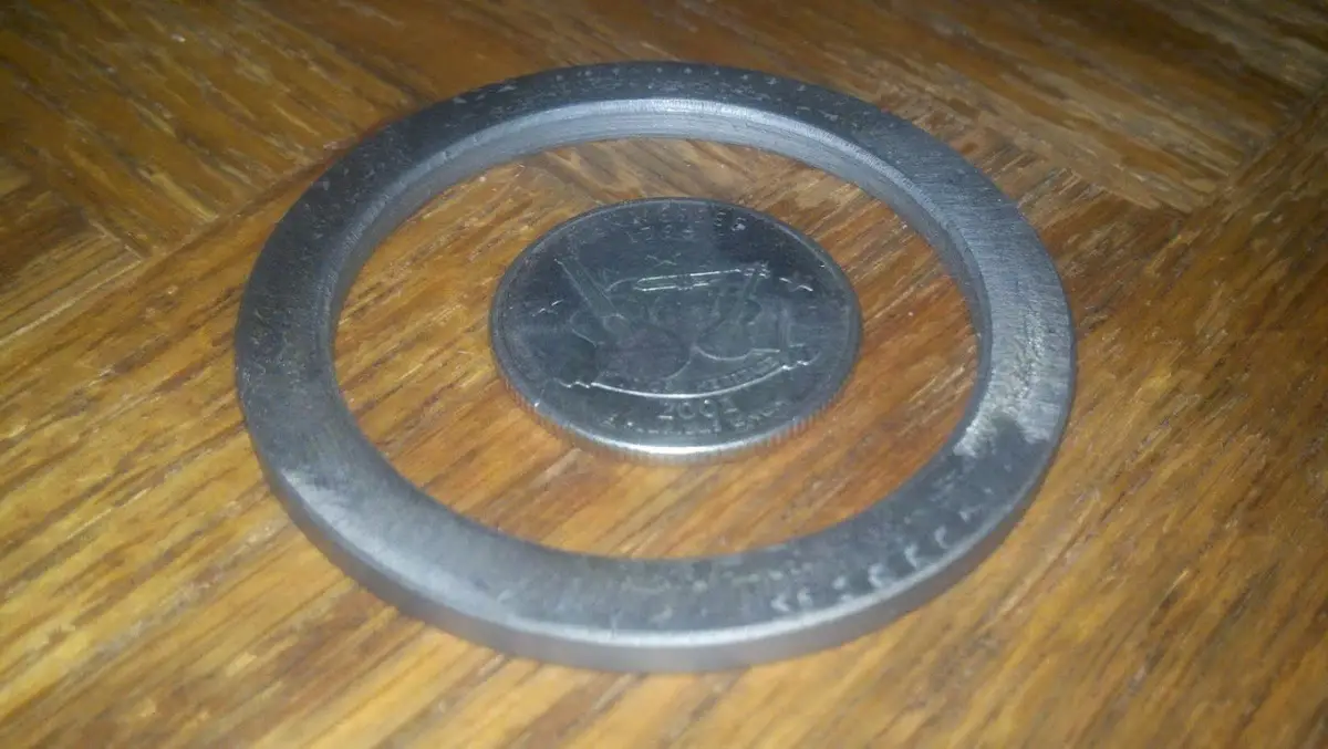

I had this same issue. The cause of my problem was the little flat spring underneath the piece with the three "wings" had apparently squished over time which means it doesn't have enough strength to align the pieces properly. I had my buddy machine me some specifically sized washers to fit just underneath the three wing piece to take up the slack. My hubs work like they are brand new after that.
