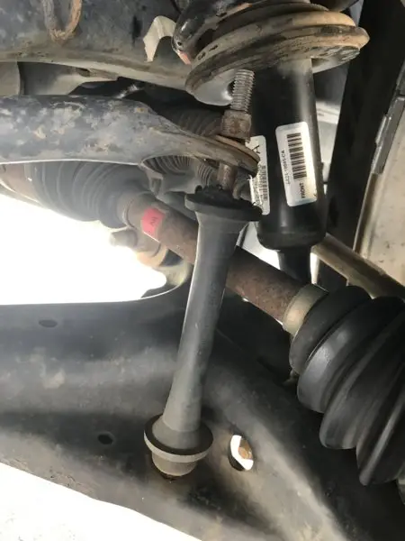

I installed the Supreme Suspension Lift similar to the truxxx lift earlier this year. I love the look of it and clear 265/70/17s just fine. The only issue I have is a humming sound and feel some vibration coming from the front end. Any help on what it could be? Thanks
Just check it out and the bushings on the sway bar links are shot on both side. Could the leveling kit have caused this and could this be the cause of the vibration?
Since putting on my truxx lift I seem to go through more upper ball joint boots and sway bar links. The humming may be from the wheel bearings.
shot ? lmfao non existing!
