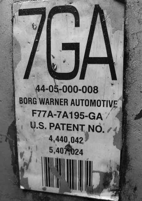

can i ask does your case have a speed sensor and what model is it? is it a ga? (f77A)
well thats the one i have been askin for thinking it might be the one im after but im not sure.
ill check on this for you tomorrow cauz the transfer case is sitting outside in the shed and im deathly afraid of spiders - especially in the dark when i can't see them. i saw a plump orange one 2 days ago and i destroyed that spider with a can of Raid. that *******!! anyways, i should have the number for you by like 2:30pm (eastern daylight saving)
here's the sticker on the 97 transfer case (the one with the speed sensor on the rear output).. so your right, the one you want is the 'GA' version.

well i went junk yarding and , i found nothing, nothing that looked good. heres what puzzeld me, i found a 7ga with a speed sensor, but it didnt have the tod sticker like all the other tod cases have. it had the 4 bolt output to the front not the cup. but this is the same number as mine and yours but was diffrent what gives? ]

88mustanggt said:
...found a 7ga with a speed sensor, but it didnt have the tod sticker like all the other tod cases have. it had the 4 bolt output to the front not the cup. but this is the same number as mine and yours but was diffrent what gives?
my guess is that this is from a 95 or 96 explorer - those might have came with the 4-bolt front output to mate with a double-cardan front driveshaft. below is an image of such a driveshaft (except this one is purely from a first generation - 91 to 94 ; ignore the arrow).

thanks man, should i be conserned at all that it didnt say tod anywhere on the case? all the other ones i saw said it
you may want to ask gijoecam about that one cauz i'm not 100% sure. but my assumption is that the transfer case are the same. i guess just make sure the electrical connectors are the same. if not, i guess you can always just take ur old electric shift motor and put it in this one your getting from the yard. also make sure the electromagnetic clutch's brown wire is present. the electromagnetic ring, as im sure you've seen, is located at the back of the transfer case near the rear output shaft. so the wire should be somewhere around there.

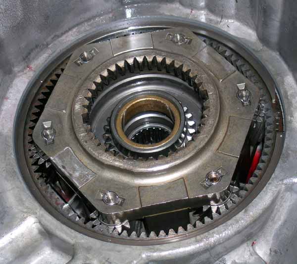

This is the planetary gear located at the front of the transfer case. At the other side of this gear set are the input splines of the transfer case that connects the transfer case to the output shaft of the transmission.
The other part of the planetary gears is this gear pictures below. The position of this gear dictates whether the transfer case is in "HI" or "LO" position.
The position of the gear above is controlled via the shift fork. The shift fork plus the gear pictured above looks like this:
