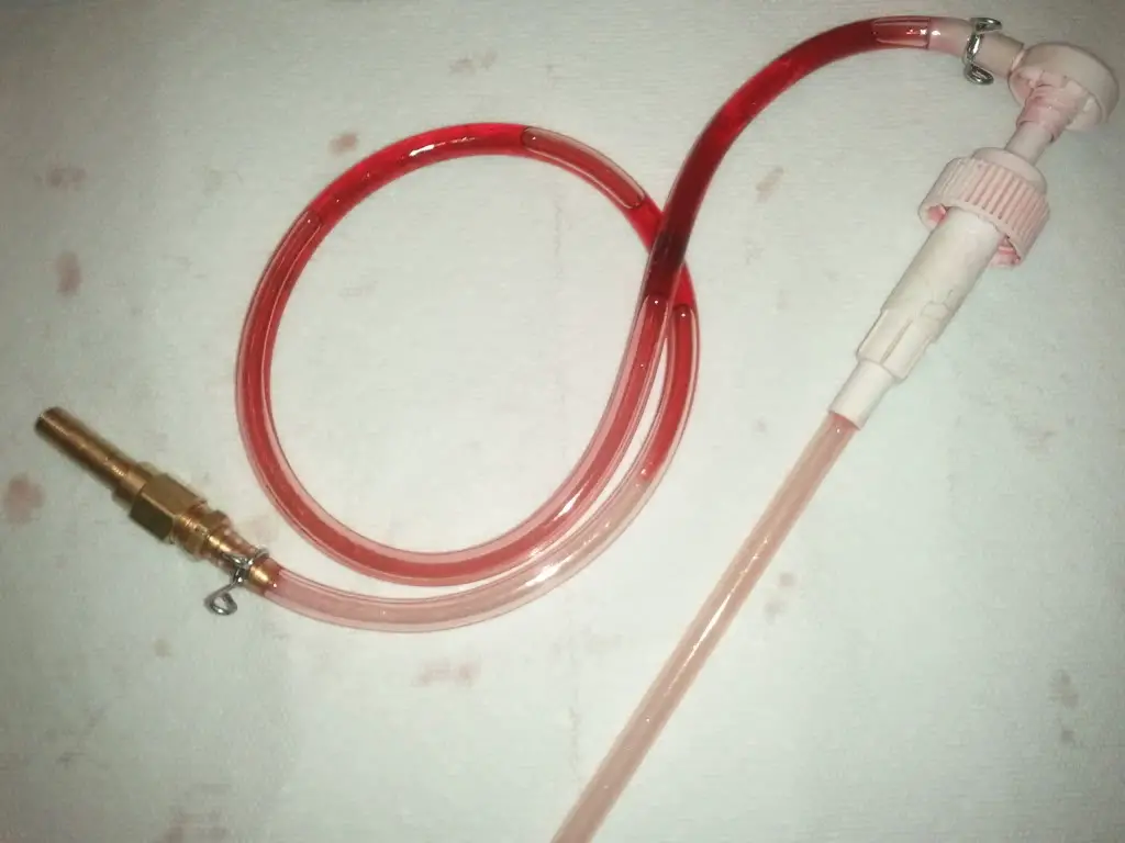

Pump from pep boys brass fittings from Hmedepot. The brass nipple that fits inside the torx plug drain hole is a 7/16 wrench. Take the plug to Home depot. Find the nipple then build the other brass fittings from there.
