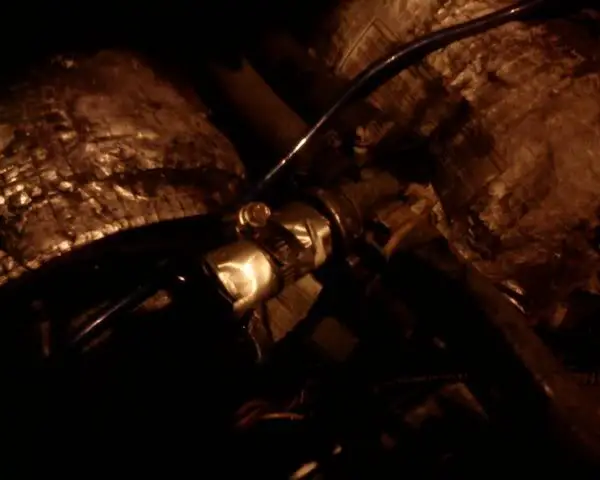

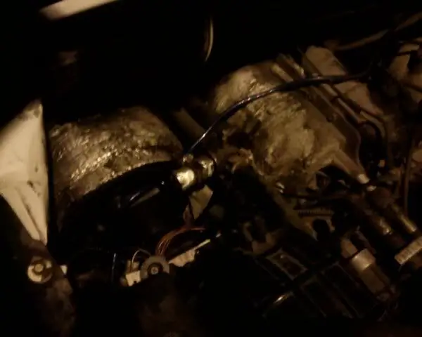

what is this and how much does it cost....it blew up on me today....i think it might be the thermostat... its near the passenger side windshild...truck has a hard time to start...but it does...temp guage doesnt work anymore...i plugged off both ends with some duct tape and hose clamps so i can move...though its probally not the best idea right now... thanks for your quick replys
Could it be the crossover thing for the heater core?
Turn on the flash ;) Or get more lighting up there
yeah, heater valve/crossover. Not too costly rockauto.com or local store, and 5/8 (I think) hose.

Its called a heater control bypass valve. Early Explorers didn't have it.. The hoses from the engine (intake and pump) went directly to the heater core.
The heater control valve is a piece that doesn't let water into the heater when your on max a/c (I believe its only the max a/c setting that blocks the water from the heater).
This means you have two choices..
Option A : take the hoses from the engine and connect them to each other. This means you won't have head but you need less parts
Option B: put 5/8 couplers where the heater control valve was to connect hoses A to C and B to D. This will give you heat but not give you the best a/c performance.
The best option of course is to get a new heater control valve.. its a $20 part if I remember correctly (autozone/checker/kragens does carry it).
btw.. I couldn't tell from your pics but your drawing does look like the heater control valve... here is a pic of it just to make sure we are all talking about the same thing.
EDIT: I checked autozone.com and they sell the part for $18.99.. p/n 5954
