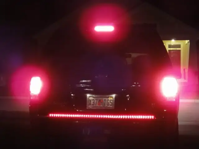

While picking up parts at Advance a couple weeks ago they had Line of Fire lights on clearance... they had the 60" and 49". The 49" fits my 3rd gen nicely. And I could not pass it at $20
Installation was not hard, just used some self tapping screws to the ledge under the hatch, and drilled a hole so the wires would go under the bumper. Ive got the Trailer wiring already there so it was really easy to join and solder the wires.
Here's a video of my wife doing a light show :D

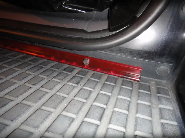

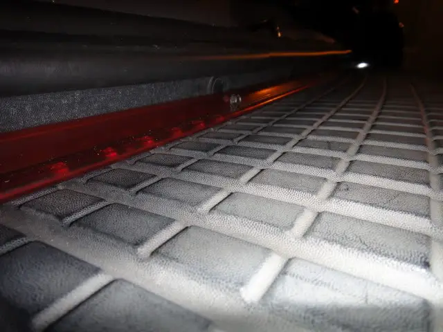

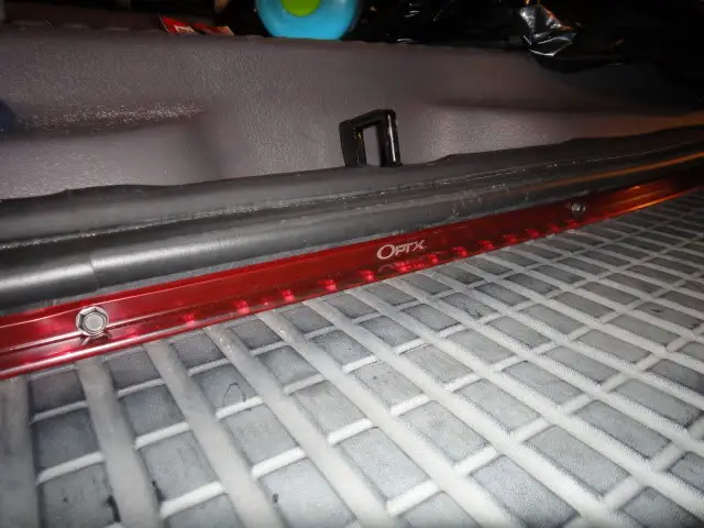

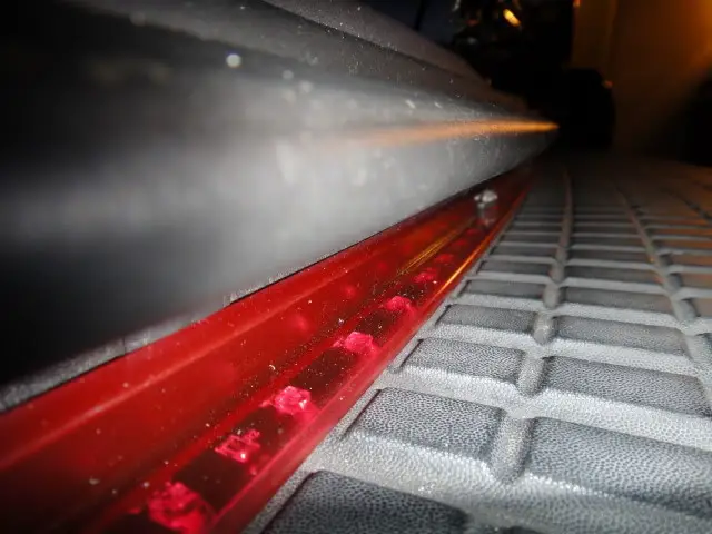

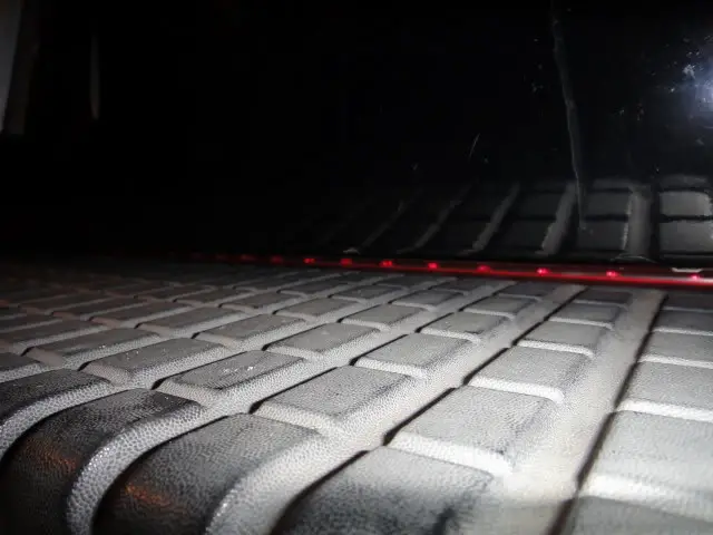

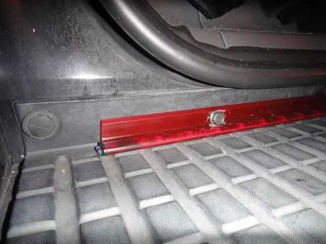

Hear ya go.
You can see the lights are in 'L' shaped red plastic
Just screwed it on.
I drilled a 1/4" hole down though on the left side so the wires would tuck under nicely and be better protected.
With the hatch down, you have to get low and look under, its not easily visible. I just watched my wife drive away from the house, and I could easily see the brake and turn signals when she stopped at the end of our street about 1000 ft away.
