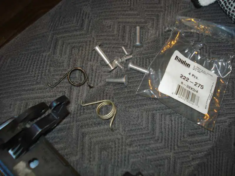

Re : door handles
I just did this, what a pain in the ass. You can't get the parts in Canada so you have to rebuild it yourself, finding a wedgewood blue ex at the junkyard is not easy.
Here is what I did.. The springs break and have to be replaced, sounds easy but the door handle is riveted in and the bolt that holds the spring is also riveted or welded together and is mean to be thrown away after you remove it.
So the fix is at home depot. You have to go to the bulk section and in little bags they have a 4 pack of screws that look like rivets with slim heads. You can't just put the 29 cent screw in there because the door handle will never go back in. There is only 1mm of space on each side to fit the handle back in.
Get these rivet screw things and put the new springs over them, you will have to remove springs from some other junk or another broken ex like I did.
The main door handle rivets can be knocked out with a screw driver and hammer, if that fails you can drill them out, then a bolt has to removed to drop the window guide and then a yellow clip becomes visible, once you unclip that the handle comes out. I had to get in there with needle nose pliers and remove the old rivet ends.
Because of vibrations and constant openings you have to put a drop of crazy glue on the screws threads to keep them locked. I also used the same rivet ends to hold the handle in, so for $3 you can do the fix but its time consuming. I've seen some people rivet the door handles in with washer, that looks weak to me. I also sealed the area with gasket maker and the whole section is solid now.
The screw kit
The repaired handles
