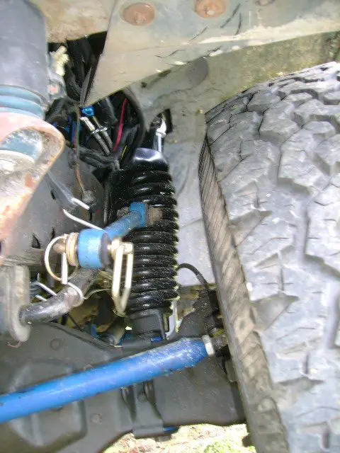

Got the coils today, and they are about 1" shorter than the Superlift coils.
I rummaged through the garage and found 1 of my F-150 coil seats, and if I can find the other one, then I will go ahead with the install of the new springs. As I can only imagine how low the front end would be if I were to go ahead and put them in:rolleyes:

Got them installed last week, just in time for the annual camping trip over the weekend. The coils are definitely softer than the Superlift ones, and even with the coil spacers in there, the front is definitely sitting about 1" lower than it was originally. So, while the 6" Skyjacker coils for a Ranger do work for first gen Explorers, you definitely are not going to get 6" of lift out of them.

You'll only end up with 4.5" not the advertised 6"
Thats the reason for the F-150 spacers. I've been concidering 8" coils to try and improve wheel travel.
